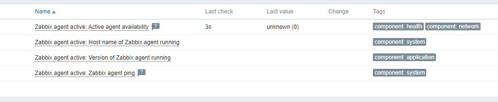

                      And what can I use to monitor that a remote host is up? ICMP is no good as remote host is behind a NAT modem. So active is OK - but on my active test setup I don't seem to be getting data.
                      Click image for larger version  Name:	image.png Views:	0 Size:	19.8 KB ID:	470558

                        Why you are using active? If you have installed the agent then you can use the template Windows by Zabbix Agent. It will check the agent status.
                          I am testing on my LAN - but I plan to be able to use this to check remote hosts over the internet that are behind other firewalls.
