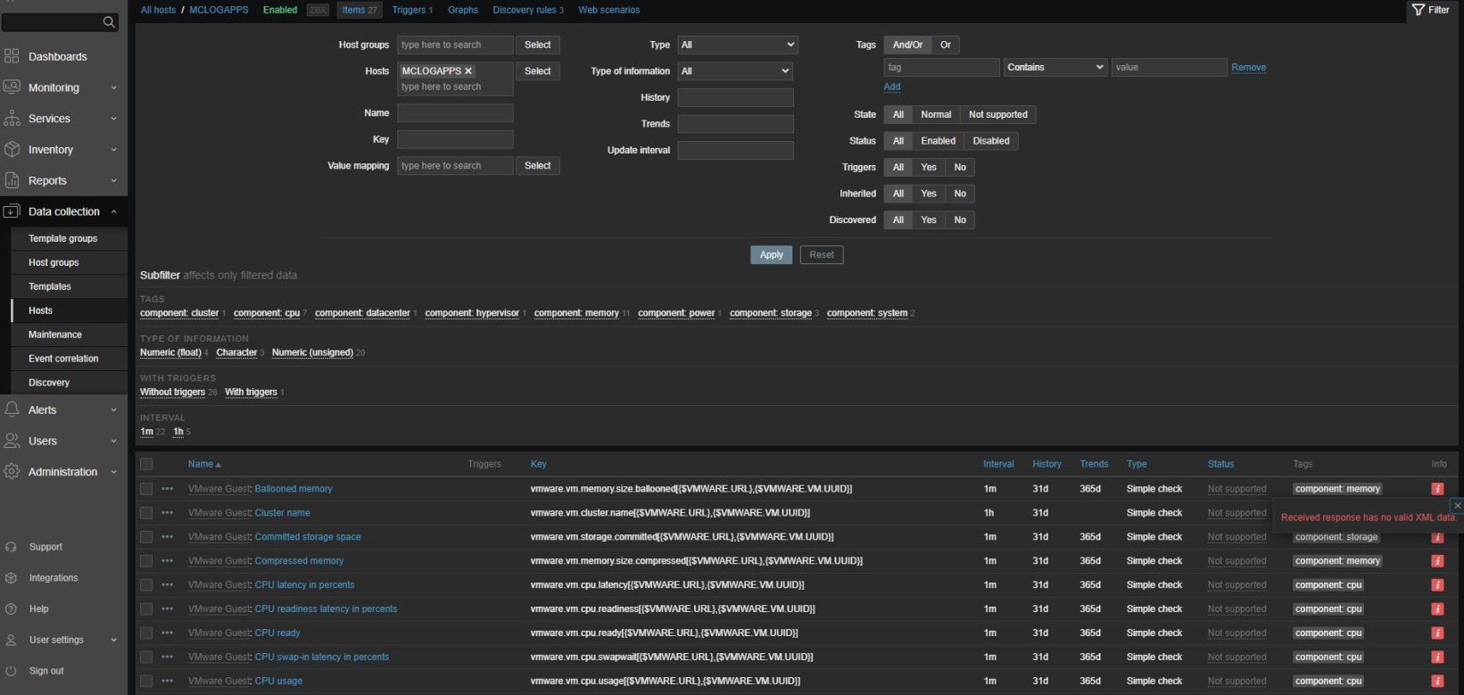

                We are experiencing the same issue- "Received response has not valid XML data" in the "Info" field each item associated with a VM in our environment. Please see attached screenshot.
                Any help is very much appreciated.
