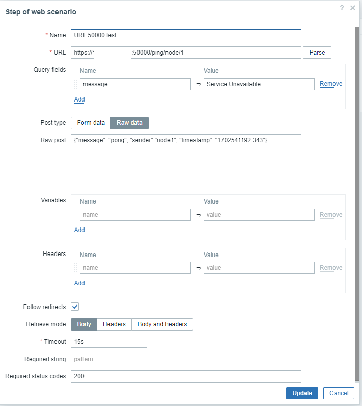

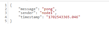

    When we go to the node (example https://172.172.172.1:50000/ping/node/1) we get the information (see picture 1)
    But when i turn off the services for node 1, you will see the following information (see picture2)
    Now i want to get a notification saying that node1 has returned with a message : Service unavailible
    But triggers/items/web scanario dusnt want to work, and im getting no where.
    OK, now what do i want.
    When the body comes back with message "message": "Service Unavailable" i want to trigget it on dashboard, but also, i want to get a message in email/teams.

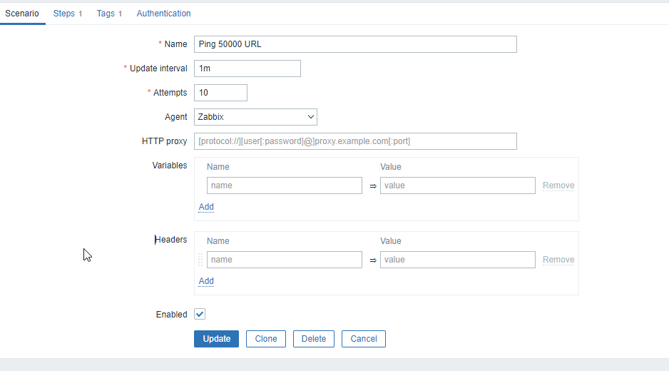

    Now i made a web scenario and trying to retrieve the body, but even getting this information back, its not working and im stuck.
    I followed the instructions https://www.zabbix.com/documentation...web_monitoring but im just getting no where.

    I would say you gave the description of what you want to achieve in rather complicated way. Plus it's not exactly clear for me where exactly you stumble and what the problem is.
    That said, I'll do a half-blind shot with giving an option to try, and if I misunderstood what you try to achieve - feel free to correct me.
    So, if you only care about response(body) returned by web request, I would step away from using web scenario, as it seem overkill for the task at hand, and would just use "HTTP Agent" item type.
    Create a new item for the host, type HTTP Agent, rest of the setup should be mostly the same to web scenario step I believe. Make sure to set type of information to "Text" and retrieve mode to "Body".
    This should result in you having item which either has JSON with PONG reply or the "Service Unavailable" in it's history. With that you should be able to create a trigger with expressions like

      When node1 is reachable, you will get the following feedback:
      "message": "pong",
      "sender": "node1",
      "timestamp": "1702563427.032"
      But when i turn off Node1, i will get the following message:

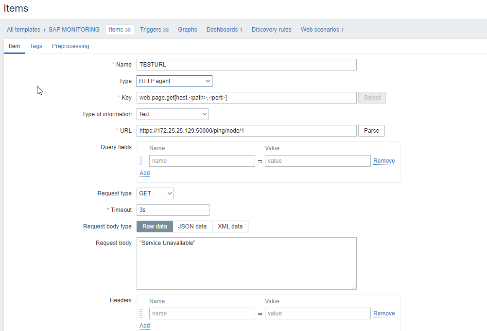

          Well thats the problem,
          I tried a few items, and triggers and web scanerio's but nothing is working, so just dont know what to do.
          Tried the following items:
          web.page.perf[host,<path>,<port>]
          web.page.get[host,<path>,<port>]
          web.page.regexp[host,<path>,<port>,regexp,<length>,<output>
          <path> = 172.172.1.1:50000
          But the url = 172.172.1.1:50000/ping/node/1 (and for node 2 = 2 etc etc)

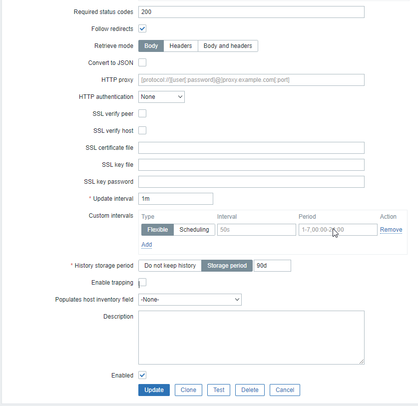

            Now for data collection, as I said in my original message, try to step away from web scenario. Create a new host item like follows:
            Name: whatever you want ("SAP 1 check" as example)
            Type: HTTP Agent
            Key: whatever you want ("http_get.sap.body" as example)
            Type of information: Text
            (bunch of params set same as you did in web scenario step)
            This should start bringing you the body of HTTP Get reply. WHEN it does and you can see the body of a request in latest data in Zabbix (and only after you verified it does!!!) you can proceed to creating a trigger. Function for a trigger that should work was also given in my previous messages.​

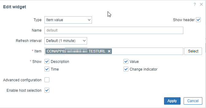

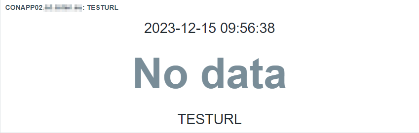

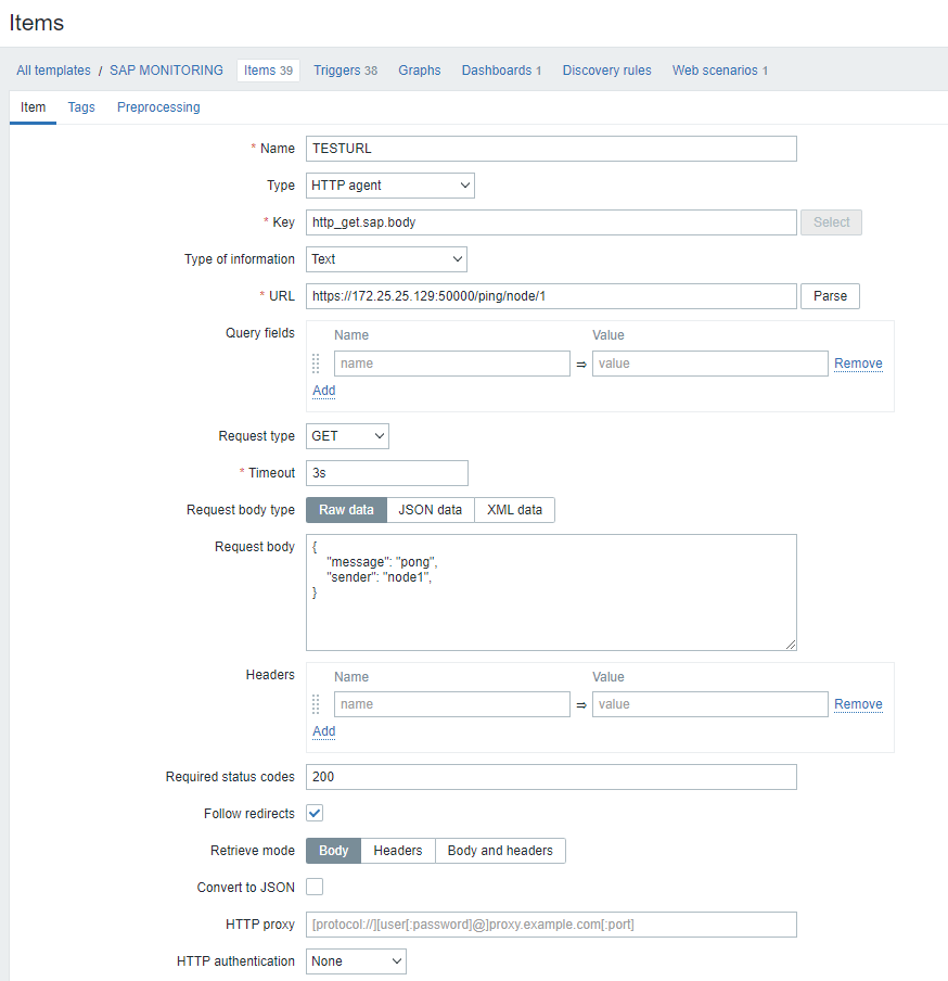

                Im trying to make new item and fill in everything.
                But even after that im getting no data in the dashboard.
                Did i forgot something somewhere ?
                Thanks for the explanation so far though ^^
                Added some screenshots, hopefully it will make it a bit more clearer
                Edit1:
                I even tried json, adjusted the body (because the timestamp change everytime ofcourse) so i removed that, but it just dont want to give me the information

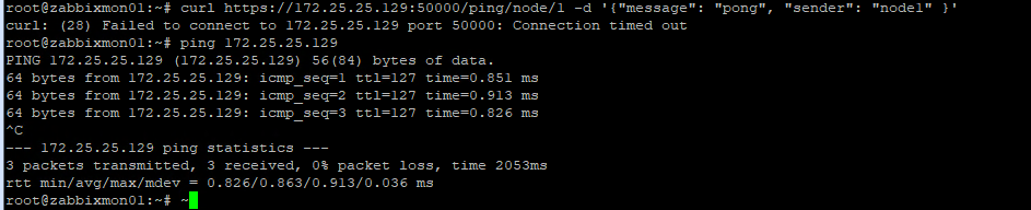

                  What is the state of the item when you open host for configuration of items? Does ti show any error state, like timeout or any other?
                  Also can you curl from Zabbix server CLI to website you try to monitor, does it respond?
                  • SpeedyGonzalesNL
                    • Oct 2023
                    • 23
                    Other items work perfectly, and i can ping all the zabbix servers./host.
                    When checking the items on host, i get error saying: Cannot perform request: Connection timed out after 3001 milliseconds

                    • ISiroshtan
                      • Nov 2019
                      • 324
                      So Zabbix does not get reply from the server you trying to send request to.
                      You can double check commuinication between Zabbix server and your web server by connecting to Zabbix server CLI and run something like
                      curl https://172.25.25.129:50000/ping/node/1 -d '{"message": "pong", "sender": "node1" }'
                      This should return you the reply that you expect to get. If it also times out - you need to check communication between Zabbix server and 172.25.25.129 node. As it seems it fails somewhere in between.
                      P.S. Are you sure your API web server don't expect any headers to be present? Usually there is a requirement for at least a Content-Type: application/json

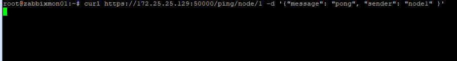

                            • SpeedyGonzalesNL
                              • Oct 2023
                              • 23
                              #15
                              Results from the Zabbix server
                              Click image for larger version  Name:	afbeelding.png Views:	0 Size:	4.3 KB ID:	475965​
                              This is all hes getting. No error just this and nothing happens
                              Pinging from Zabbixmon01 to the Ip adress works:
