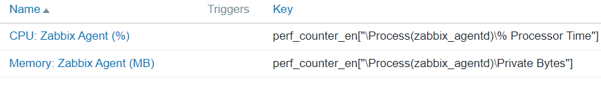

                    this seems to work​

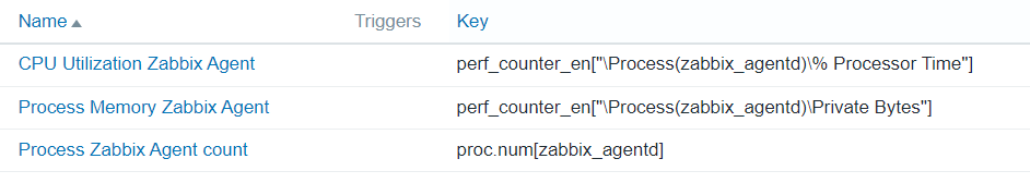

                        Windows agent ram/cpu
