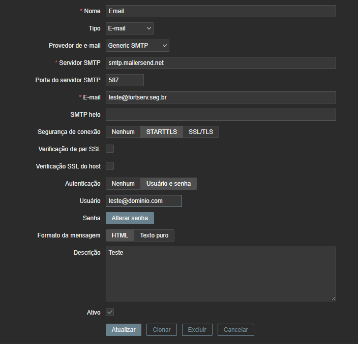

      Guys, I'm encountering the following error. When I send the email via command, the email is sent normally. However, if I send it through the web interface, I get the error 'Failure when receiving data from the peer'.
      Below is how my environment is set up. Do you know what could be the issue? The Zabbix version is 6.4.18. The command that works is: curl -v --url smtp://smtp.mailersend.net:587 --user 'userassword' --ssl-reqd --mail-from '[email protected]' --mail-rcpt '[email protected]' --upload-file mail.txt.
