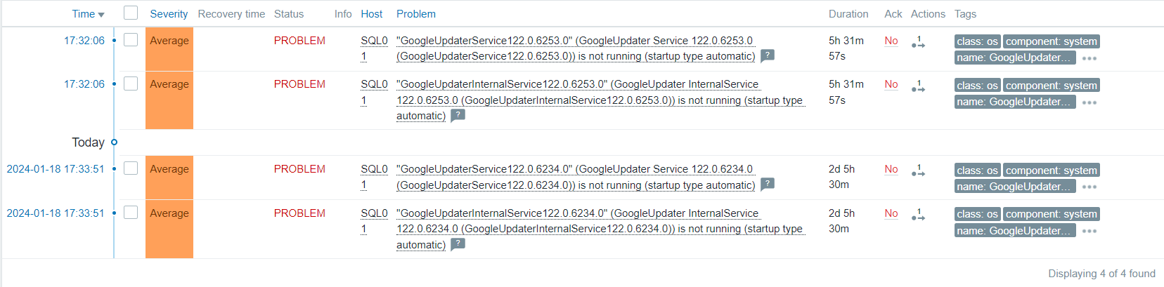

    I'm running Zabbix 6.0.25 on AlmaLinux 9.
    I have Zabbix Agents 2 running on several servers.
    They keep giving me alerts about Google services not running.
    I disable them but they keep happening. I think the problem is that the version keeps changing so the name of the service changes.
    I would like to know how to exclude these so that it stop warning me. Can someone explain to me how to do it?
    Thank you.
