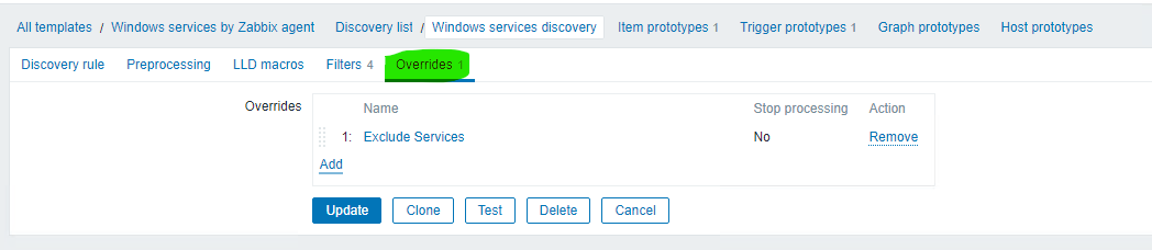

    I had this same issue and believe I resolved it using an Override in the Windows service discovery rule:
    Click image for larger version  Name:	image.png Views:	1536 Size:	19.2 KB ID:	483668
    We can use regex here, so can create a filter rule for any service that contains GoogleUpdater:

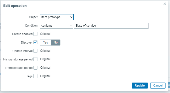

    Then in the condition, we can get the object we want the override to apply to, which in this case can be item prototype. Just need to state which item prototype to apply to using the condition, then override the Discover option and set to No:
    Click image for larger version  Name:	image.png Views:	1520 Size:	22.6 KB ID:	483670
    So when the discovery rule runs, it will evaluate against the Override and should not create an item for any service containing GoogleUpdater. You could also override the Create enabled option and set that to No as well, just as an extra catch, however it's probably not required.

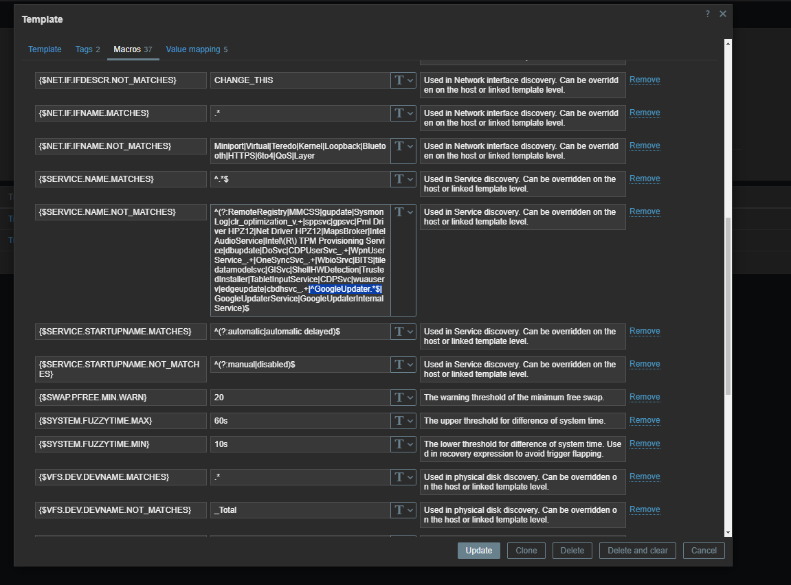

                Zabbix 7.0+
                Templates -> Windows by Zabbix agent​ -> Macros -> {$SERVICE.NAME.NOT_MATCHES} -> add |^GoogleUpdater.*$| -> after that, delete the template from your host with a complete cleanup, save it, and add it again.

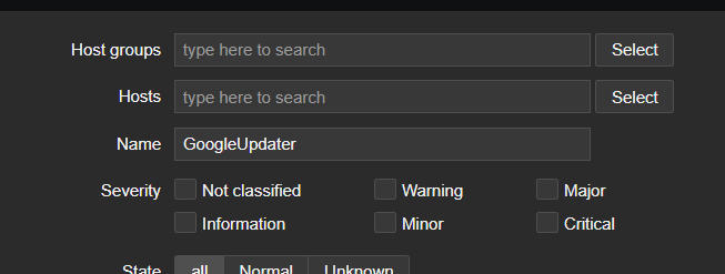

                    You can do it in configuration->hosts-> triggers and then modifying the filter to
                    No need to mess around in DB...
                        ​So when the discovery rule runs, it will evaluate against the Override and should not create an item for any service containing GoogleUpdater. You could also override the Create enabled option and set that to No as well, just as an extra catch, however it's probably not required.
                        You could also do the same theory but against a Trigger prototype, in the case where you do want the item to be discovered and collect the data but don't want the alerts to be enabled etc.
                        Thank you. This resolved the issue, and set it up so that it doesn't come back. And I was able to use the suggestion to add an Override that disables the Trigger for the BITS service. Which seems to be a service that stops and starts regularly. Disabling the Trigger allows Zabbix to keep gathering the data, while not alerting me everything the service stops for a bit.

                            Originally posted by Ma33x
                            Zabbix 7.0+
                            Templates -> Windows by Zabbix agent -> Macros -> {$SERVICE.NAME.NOT_MATCHES} -> add |^GoogleUpdater.*$| ​
                            Thanks for Ma33x​.Work for me, Zabbix 7.2.5
                            Modifying the Templates will automatically apply.
