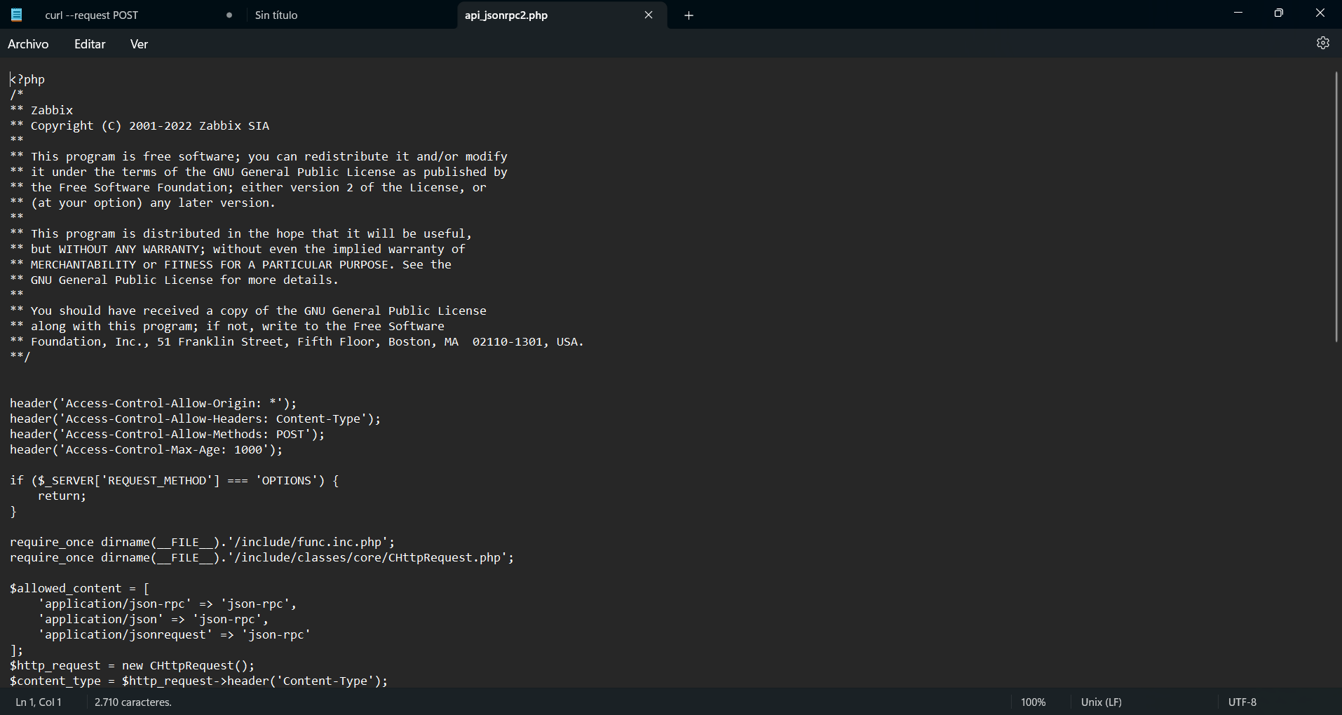

        Thank you, anyway I remember checking if it was there because I was getting 'api_jsonrpc not found.' I will search again on the server. If, in a hypothetical case, it is not there, I have been looking in the Zabbix git for the file for version 5.4.0, and when I upload it to Zabbix, I get a 500 http error. Do you know what could be causing this issue? I emphasize that I will search on the server again when they reopen my permissions
        This is the code i was putting inside the server as the api_jsonrpc.php
        header('Access-Control-Allow-Origin: *');
        header('Access-Control-Allow-Headers: Content-Type, Authorization'); // Añade Authorization aquí
        header('Access-Control-Allow-Methods: POST, GET');
        header('Access-Control-Max-Age: 1000');
        if ($_SERVER['REQUEST_METHOD'] === 'OPTIONS') {
        return;
        require_once dirname(__FILE__).'/include/func.inc.php';
        require_once dirname(__FILE__).'/include/classes/core/CHttpRequest.php';
        $allowed_content = [
        'application/json-rpc' => 'json-rpc',
        'application/json' => 'json-rpc',
        'application/jsonrequest' => 'json-rpc'
        // Establecer el token directamente (reemplaza 'tu_token_aqui' con tu propio token conocido)
        $apiToken = '**********************************';
        // Establecer el token en la instancia de la clase API
        API::getWrapper()->setAuthToken($apiToken);
        $http_request = new CHttpRequest();
        $content_type = $http_request->header('Content-Type');
        $content_type = explode(';', $content_type);
        $content_type = $content_type[0];
        if (!isset($allowed_content[$content_type])) {
        header('HTTP/1.0 412 Precondition Failed');
        return;
        require_once dirname(__FILE__).'/include/classes/core/APP.php';
        header('Content-Type: application/json');
        $data = $http_request->body();
        try {
        APP::getInstance()->run(APP::EXEC_MODE_API);
        $apiClient = API::getWrapper()->getClient();
        // unset wrappers so that calls between methods would be made directly to the services
        API::setWrapper();
        $jsonRpc = new CJsonRpc($apiClient, $data);
        echo $jsonRpc->execute();
        catch (Exception $e) {
        // decode input json request to get request's id
        $jsonData = json_decode($data, true);
        $response = [
        'jsonrpc' => '2.0',
        'error' => [
        'code' => 1,
        'message' => $e->getMessage(),
        'data' => ''
        'id' => (isset($jsonData['id']) ? $jsonData['id'] : null)
        echo json_encode($response);
        session_write_close();

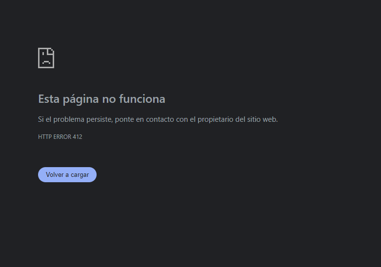

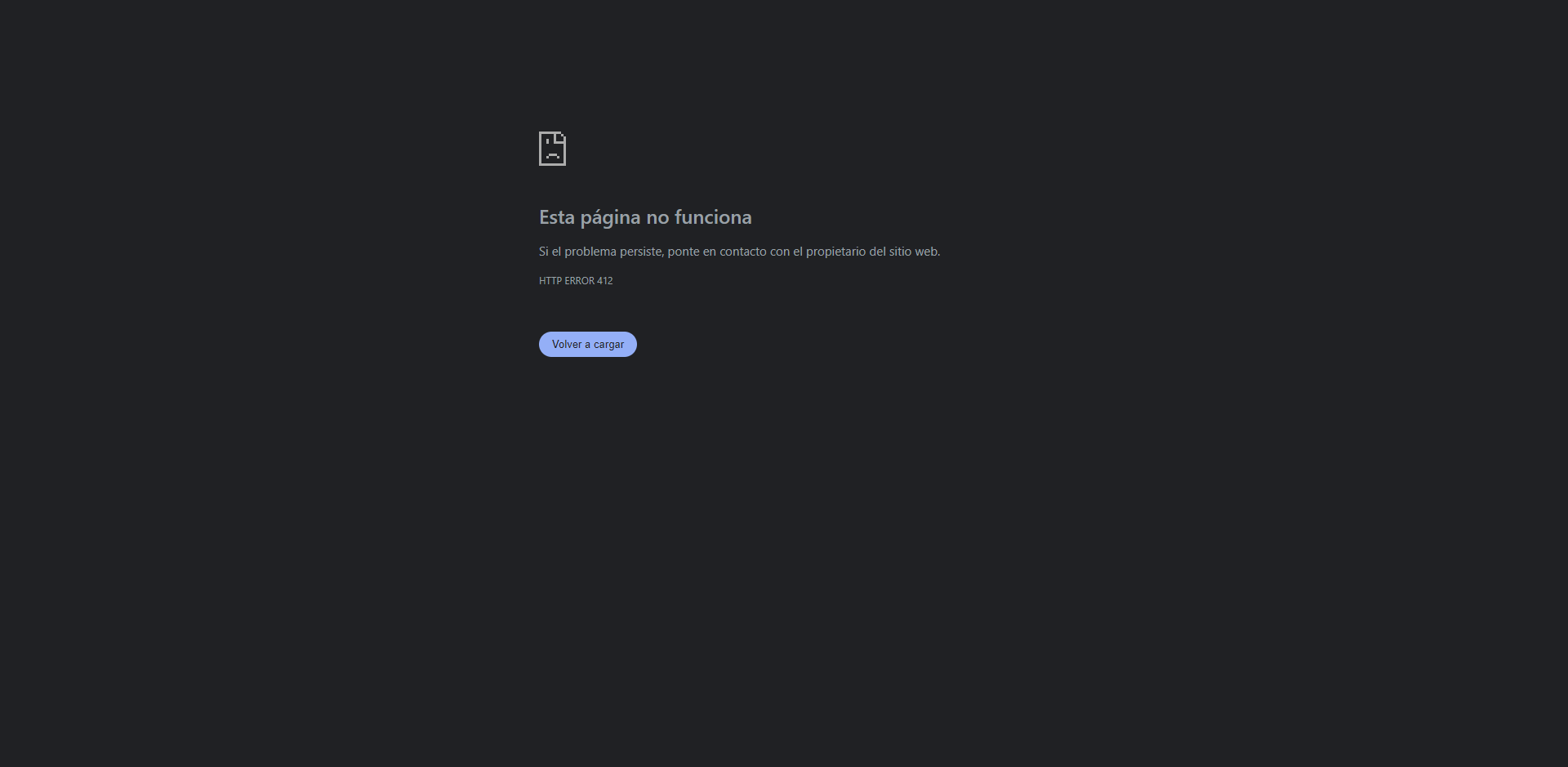

            Hello again, I have checked in the directory /var/www/html/zabbix, and the file api_jsonrpc.php is there; it is the same as the code from the page you provided. I have deleted the one I had uploaded with the API token issue. Now, the error when accessing the URL has changed from HTTP Error 500 to HTTP Error 412.
            • jlenoci
              • Jan 2024
              • 25

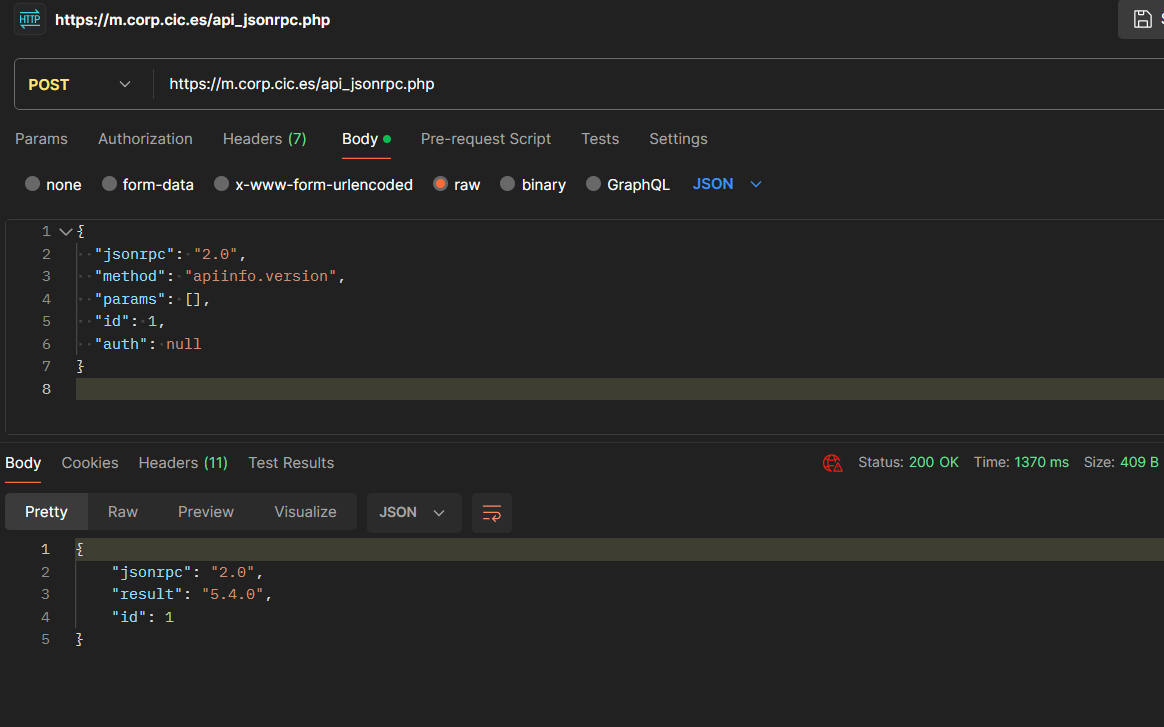

              Now I'm getting responses that I didn't have before, but I can't access the website through the URL with api_jsonrpc.php. I'm entering the URL like this: https://miserverexample/api_jsonrpc.php​
                • 5002
                ok .. you get already some answers (api version), now authenticate yourself to API and then perform your requests... https://www.zabbix.com/documentation/5.4/en/manual/api plenty of examples...
                • jlenoci
                  • Jan 2024
                  • 25
                  I have been testing, and I'm receiving good responses. My API implementation is for Power BI. Thank you very much for the help, truly
