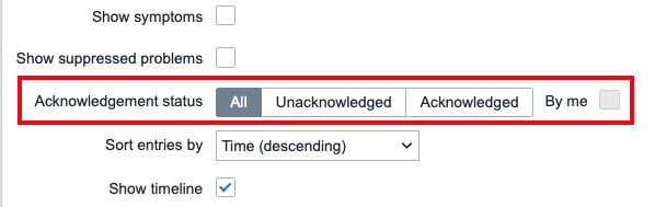

ID:	478446 Do you see this in the Problems widget configuration?

      Originally posted by dimir
      Click image for larger version  Name:	Screenshot 2024-02-06 at 11.38.26.png Views:	2 Size:	22.0 KB ID:	478446 Do you see this in the Problems widget configuration?
      No. Here are the settings I see.
ID:	478455​I think the issue is I have disabled triggers that weren't acknowledged, is there even a way to clear them?
      • dimir
        Zabbix developer
        • Apr 2011
        • 1080
        There should be a Problem display with possible options All, Separated, Unacknowledged only: https://www.zabbix.com/documentation...blems_severity
