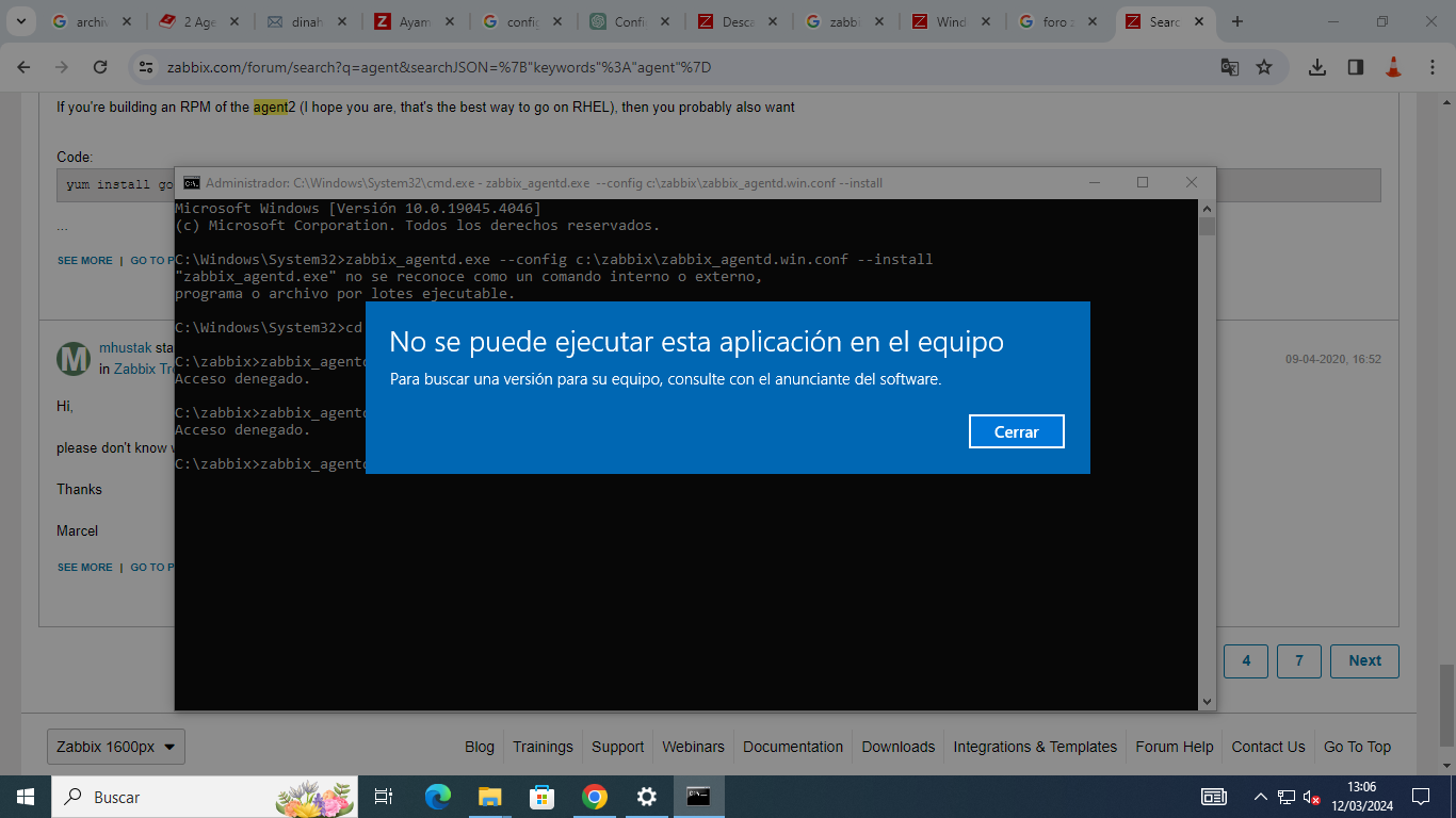

          Good morning, I'm new to Zabbix and I'm having trouble automatically monitoring devices with Zabbix. I have installed the server and installed the agent on Windows. Zabbix is not finding any devices within the range of IPs that I have set, when it should at least find this device that has the agent. I have uninstalled the agent and tried to install it via command, but I get this error. Any solution? Thank you.
