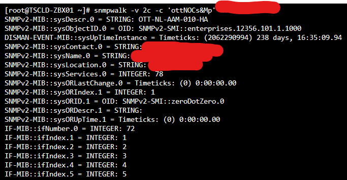

          So i've installed snmpwalk and tried the command on the only host where it works and it's giving a reply back. I've checked my networking and all the hosts are configured the exact same, it should make no difference.
          But after doing SNMP to another host with a slight different IP, while having the same policies etc, it fails. Would you by any chance know how to troubleshoot this?
