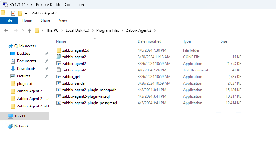

          I have checked it, when we do the installation then the plugins show it. find the below screenshot but that is for Linux machine.
          We have windows Server, we need to require plugins for windows machine with Zabbix Agent 2 as per my thinking. as MSSQL also available for Linux as well.
          i have try to copy that MSSQL.conf file in windows and also modify the zabbix Agent 2 file as well but after that the agent service not able to start it.
          require guidance from Zabbix team whether is it supported to windows server or not of MSSQL?

          • pulpet90
            • Apr 2024
            I have same issue.
            Agent version 6.4.13, same as server version.
            I have added mssql.conf to plugins on my windows agent folder but still have same error: Unknown metric mssql.perfcounter.get
            mssqlconf have 3 lines unhashed in config:
            [B]Plugins.MSSQL.Default.Uri=sqlserver://...
            Plugins.MSSQL.Default.User=zbx_monitor
            Plugins.MSSQL.Default.Password=...[/B]
            Agent is running but still no MSSQL data.

                • espenta
                  • Oct 2022
                  Thank you pulpet90!
                  Downloading Agent 2 and the plugin msi-file from you repo URL solved the problem for me. We were unable to get the already installed Zabbix Agent 2 version 6.4.13 package to work with the plugin, but reinstalling the Zabbix Agent 2 made it work out of the box.
                  Zabbix proxy log showed some info, but it did not lead us on the right path. I tried all sorts of macro variations without success, still same event logged:
                  Zabbix agent item "mssql.local.db.get["{$MSSQL.URI}","{$MSSQL.USER}","{$MSSQL.PASSWORD}"]" on host MYSERVER failed: another network error, wait for 15 seconds
                  When the plugin was accepted by the Agent, the data became almost instantly accessible and the proxy log showed this line:
                  enabling Zabbix agent checks on host "MYSERVER": interface became available
                    Seems like since appearance of the plugin (with version 6.4.12), docs have not been updated correctly about obtaining the plugin etc..
                    Or... you can probably guess they way it works from Plugins page https://www.zabbix.com/documentation...nsions/plugins but its not that easy to put everything together easily...
