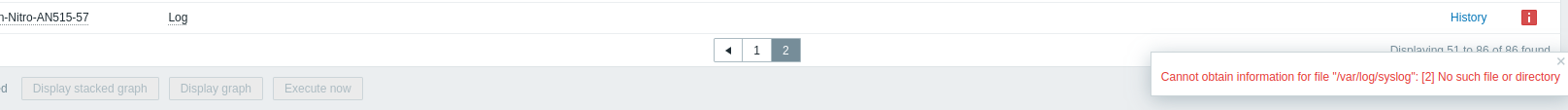

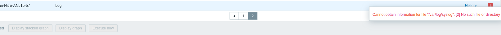

    Hello everyone, I want to monitor the logs of my operating system with zabbix docker but I get the following error.
    My agent configuration
    Server=Zabbix Server Container IP
    ServerActive=Zabbix Server Container IP
    Hostname=can-Nitro-AN515-57 -->My hostname
    Host Template
    My Log Item
    I changed the group of the syslog file to docker but nothing changed.
    Any ideas, I would be very grateful if you help me.​

      Hello. Can you please check if the user zabbix actually has permission to read the file? su zabbix -s /bin/bash -c “tail /var/log/syslog” And also list on the /var/log folder with ls -al
      • bastus11
        bastus11 commented
        First of all, thank you for your answer, but since I installed it with docker, there is no user called zabbix on my host.
      • korayak88
        korayak88 commented
        No Bro. You can do it. You should execute su zabbix -s /bin/bash -c “tail /var/log/syslog” command on the 172.30.0.6 (it should be installed zabbixagent). After installing the zabbix agent, the zabbix user will be created automatically.
