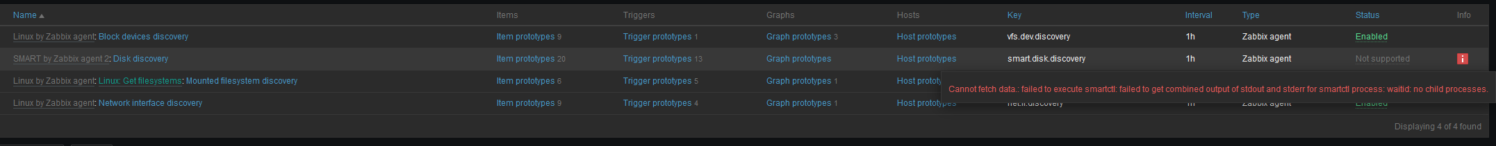

    One of the machines on which I have Zabbix agent installed on is a Proxmox hypervisor (debian 12). Using "Linux by Zabbix agent" template I am getting a lot of data collected (all working well). Now, I wanted to also gather SMART values of the drives which are installed on that system. So I went ahead and added additional template for that host "SMART by Zabbix agent 2" (following the steps described here https://www.zabbix.com/integrations/smart). I am not sure why but I am getting following error:
    Cannot fetch data.: failed to execute smartctl: failed to get combined output of stdout and stderr for smartctl process: waitid: no child processes.

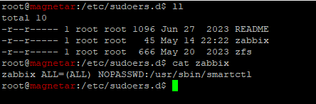

    I have a feeling this might be related to "zabbix ALL=(ALL) NOPASSWD:/usr/sbin/smartctl" part not working properly.
    Here's how my "visudo" file looks like:

    Would appreciate if someone could point me to a right direction!

                            So whats happening there is that the "zabbix" user is trying to execute the smartctl command which is a root privledged command only. The above suggestion from Markku should work for you on your machine. Typically what this means is that your zabbix system was not granted access to the /dev/sd? devices application. If his example does *not* work, then the problem is going to be in your /etc/sudoers file (either there is a hidden typo, located in the wrong order, etc.
                            Additionally, I see you used the "@includedir" function. If your sudo is 1.9.1 or earlier, that wont work and would need to be the original "#includedir" to get your zabbix entry.
                            Lastly, you have "two" zabbix entries, one in the include dir and one at the end of your /etc/sudoers file. You have to eliminate one of those or you have a conflict.
