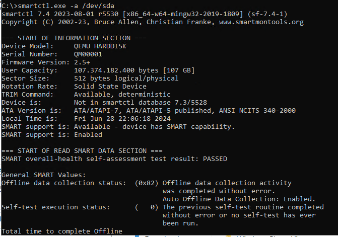

                  Thanks for your help, I'm new to using this template, please help me solve my problem.
                  I am using the SMART template in Zabbix connected to a virtual machine with a 64-bit Windows 10 operating system.
                  I have installed and configured the Zabbix 2 agent and everything works correctly, without problems, however when I connect the "SMART by Zabbix agent 2" template the data is not transmitted and therefore I cannot carry out monitoring.
ID:	486669​​I installed the "smartmontools" program on the Windows VM but even with this it does not seem to detect data. If I run the command "smartctl.exe -a /dev/sda" in cmd I can see all the data on the physical disk correctly.
                  I also saw this guide https://www.zabbix.com/forum/zabbix-...hdd-smart-data and I tried to perform these steps but without success, I always get an error
