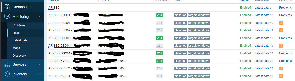

          Hello All.
          I did an upgrate to version 7 on my solution but am still have the problem when de agents switch to othen proxy.
          i set a proxies group.
          after start up both proxies some agents switch and for some reason proxies don't work well

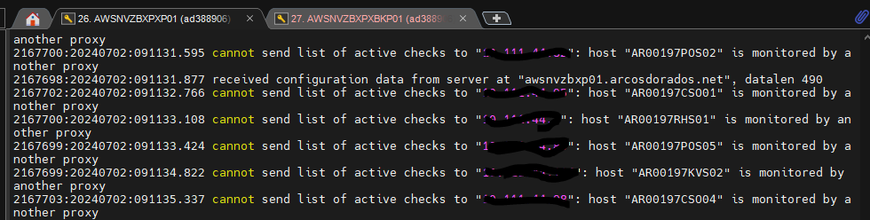

          On the proxy log the message es that host is not monitored by them.
          • Markku
            • Sep 2018
            • 1787
            How are your agents configured?
            Markku
            • PCalcina
              • Oct 2023
              • 13
              Hi Markuu.
              Thanks for the help.
              Like this.
              SERVERACTIVE=awsnvzbxpxp01;awsnvzbxpxbkp01
              i tryed to set only 1 proxy and both proxies. but in both cases the result its the same. when you stop one of them the server switch the host to other proxy, but the agent don't receive the change and try to send the metrics to the stopped proxy.
              • Markku
                • Sep 2018
                • 1787
                Did you upgrade the agents as well? If they are older than 7.0 they won't understand the proxy redirections.
                Markku
                • PCalcina
                  • Oct 2023
                  • 13
                  Hello Markku, sorry for the delay on the answer, we have all servers, proxies and agent on 7 Version, we found that this error is related to a bug, and we have to upgrade to 7.0.5. to see if the error is fixed and we could let the proxy bkp started on the proxy group.
