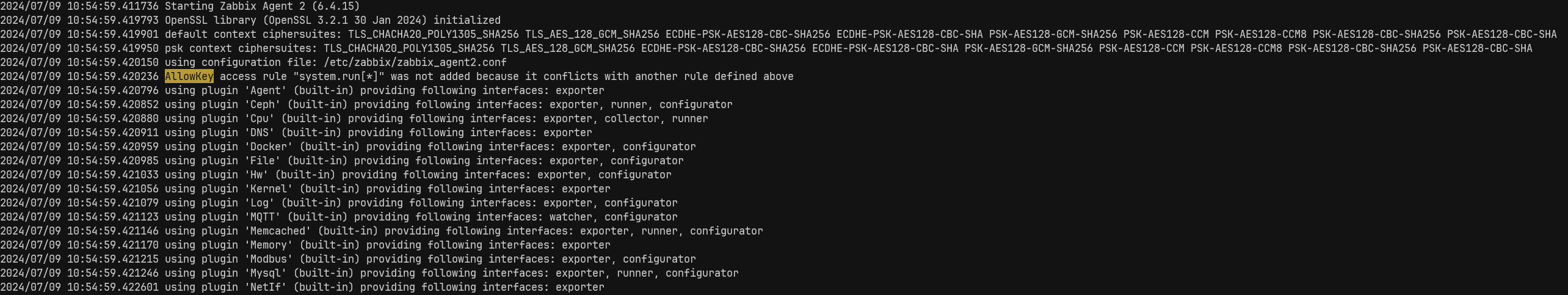

    I am trying to implement an item using the system.run key.
    I added AllowKey=system.run[*] to a hosts agent configuration file, but the agent reports:
    But I cannot find what other rules above forbid the client from using system.run?

    Nvm, figured it out. Someone snuck in a plugin.d conf file that contains DenyKey=system.run[*]. Dont know why the error says "above" when these conf.files are loaded at the very bottom of the original conf file, far under my AllowKey, but it works now so idc.
    Sorry for the trouble/clutter.
