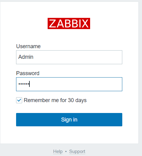

    Could it be the OS administrator account that doesn't work? Or is it the WebUI administrator account?
    I tried installing 7.0appliance in my virtualbox, but as per the official document
    Administrator account is now available.
    System:
    root:zabbix
    Zabbix frontend:
    Admin:zabbix
    This is my experience of failure, but I once wasted several hours not realizing that "Admin" is not "admin".

        Hello jronpaul
        I created a virtual environment on my home PC and tried installing the Zabbix appliance again. The login ID is root and the password is zabbix, which seems to be the same.
        Click image for larger version  Name:	fig000.png Views:	0 Size:	8.8 KB ID:	487919
        Also, if the installation of Zabbix Appliance has been completed, I think the WebUI will be enabled without you having to do anything.
        Click image for larger version  Name:	スクリーンショット 2024-07-20 112043.png Views:	0 Size:	15.0 KB ID:	487920
        At the moment, I cannot guess where the cause of the inconvenience lies.

                    It seems that the appliance performs final configuration on the first boot after installation. The error message you saw also appeared on my side. If you leave it for a few minutes, the WebUI login screen will appear.
