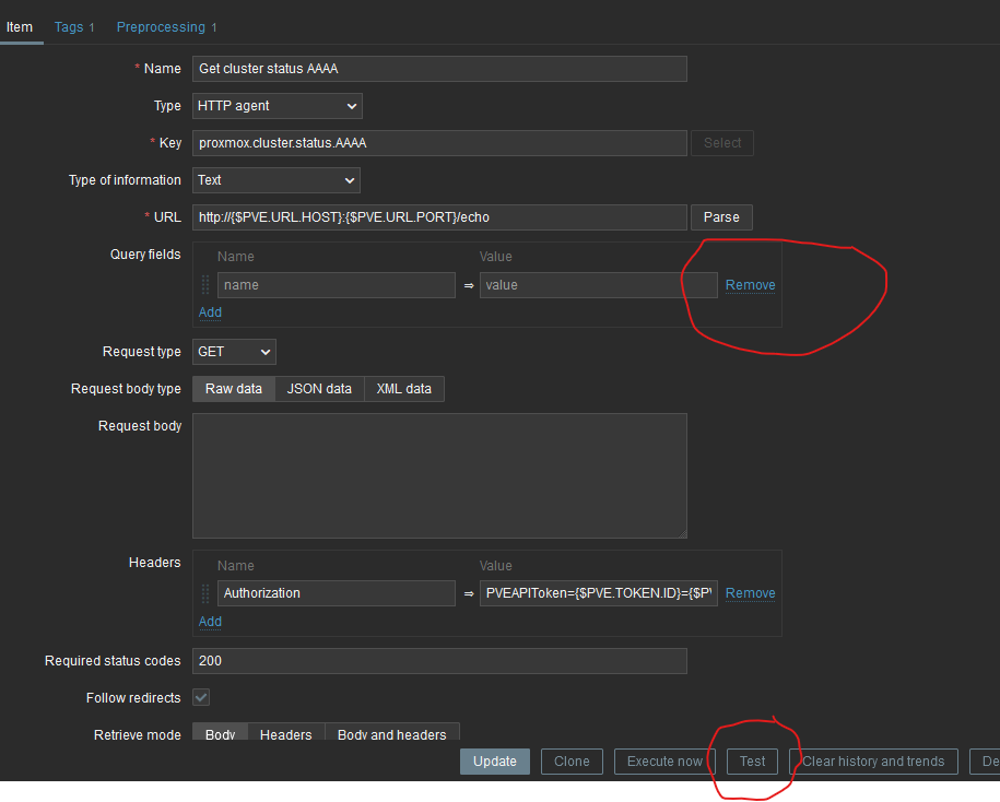

    I have an issue related to the HTTP Agent and Proxmox VE HTTP. The problem is as follows: even if the query fields are empty, Zabbix still attempts to send the call to the server.
    Click image for larger version  Name:	image.png Views:	3 Size:	4.4 KB ID:	488365
    In the Proxmox template, if I remove the empty query fields, save, and reopen, an empty query field always reappears.
    In the host associated with the template, I duplicated 'Get cluster status.' By doing so, during the test phase, I can remove the query field. However, if I close and reopen the item, Zabbix still adds an empty query field again.

    Click image for larger version  Name:	image.png Views:	2 Size:	9.7 KB ID:	488366
    The problem started after migrating to zabbix 7

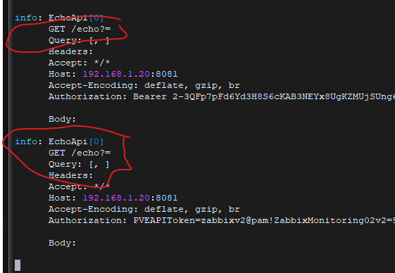

        Now, for testing, I will try creating a Docker instance just to see if the issue is related solely to the upgrade. Additionally, I will create an ASP.NET web API to check what the Zabbix server is requesting.

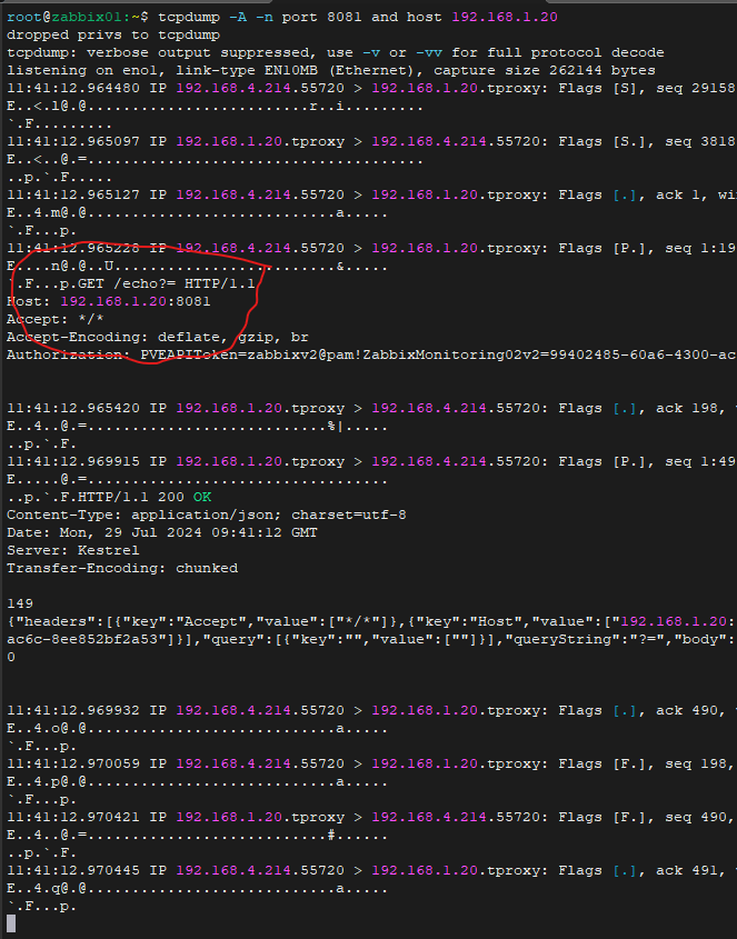

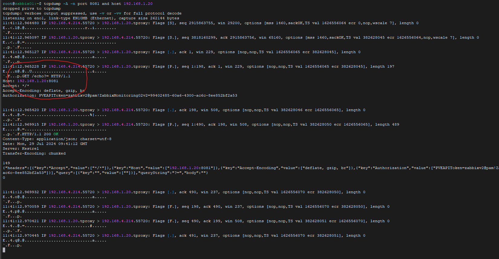

            Is there a way to "grab" http request from server?
            • Markku
              • Sep 2018
              • 1784
              Yes, using tcpdump, when using non-encrypted http.
              If testing on the local Zabbix web UI itself (using localhost = 127.0.0.1), this works:
              sudo tcpdump -A -n -i lo port 80
              GET /test HTTP/1.1
              Host: 127.0.0.1
              Accept: */*
              Accept-Encoding: deflate, gzip, br, zstd
              If using over network to remote host, capturing on the Zabbix server side, this works:
              sudo tcpdump -A -n port 80 and host x.x.x.x
              (where x.x.x.x = the IP address of the destination)
              You can also use "-w filename.pcap" option to save the capture in a file and then inspect it better with Wireshark.
              Markku

                From a web api view point
                Just to clarify
                If I click "Remove" and test everything works as expected
                But when click on "Update" and open it again an a empty query field appers​
