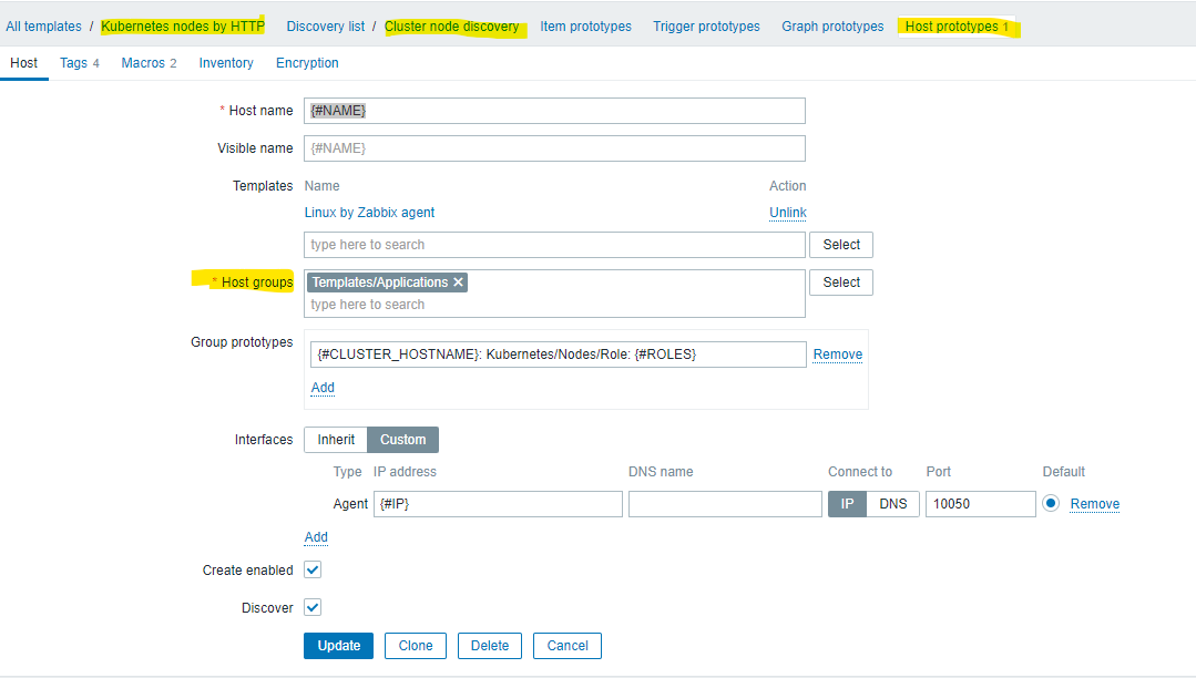

              Did you change the host-prototype host group value to the desired group?
              I don't expect a macro to work there because it uses internal linking UUID for the host group. (and making a duplicate template can be challenging )
              See image:
              Click image for larger version  Name:	image.png Views:	0 Size:	43.3 KB ID:	489552

                I changed Host groups in this way:
                • I removed Templates/Applications
                • I added my "parent" hostgroup
                Not a clean solution, it's hardcoded...
                • Brambo
                  • Jul 2023
                  • 256
                  It's not ideal but believe, when it comes to make a duplicate template it will be more work then this.
                  What you could do is make the discovery rule with filter and for each where filter matches it's own host prototype item with the group you want. Still hardcoded but host-group isn't a variable.
