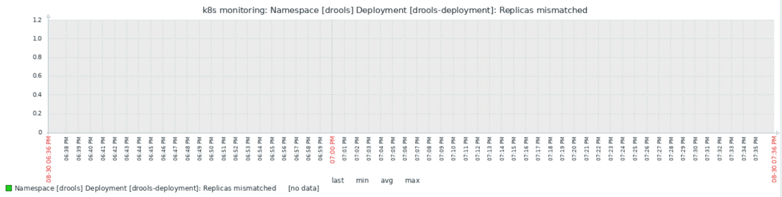

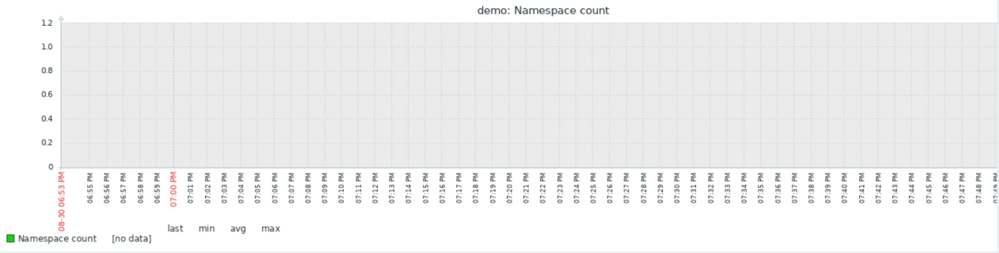

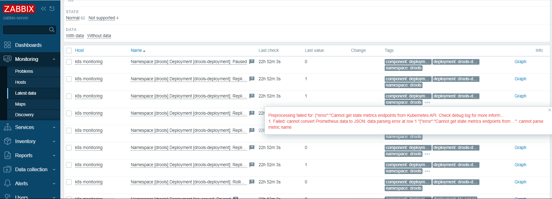

      Hi, i tried using kubernetes cluster state by http. I created the host and linked to the template. I was able to get the latest data around 2000+ but no graph and dashboards. When i check for the each data i am getting no data. And issue regarding prometheus. Can you help me how to troubleshoot this one.
      1. Created a host linked the kubernetes cluster state by http. Passing the kube_api_url and kube_api_token of the cluster in macros.
      Please do help me out to get the kubernetes cluster metrics -
        I have never used any of that. But your first pic shows error or preprocessing, which looks like your master items returns "error" instead of data and thus your other items are not abel to populate, as they do not find any needed patterns from master item.
        • samantha.v
          • Aug 2024
          Now i am able to get the data by using the temple kubernetes cluster by http & kubernetes nodes by http.
