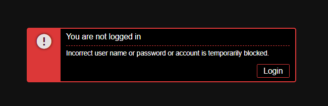

    After successfully authenticated with the Google I'm facing the below error in Zabbix page.

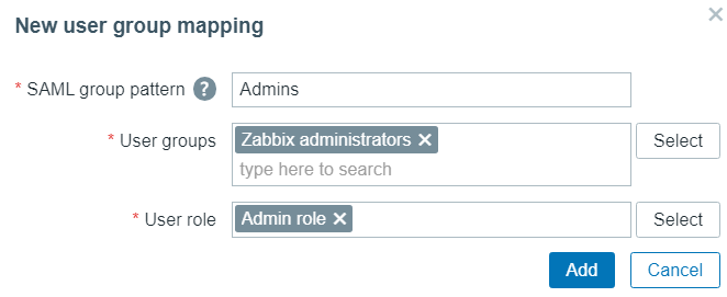

    Under user group mapping, I have added a group from google workspace in group pattern.

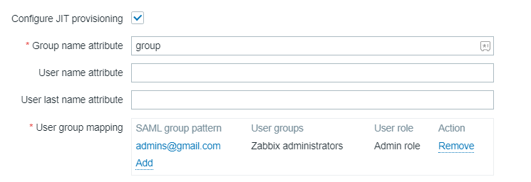

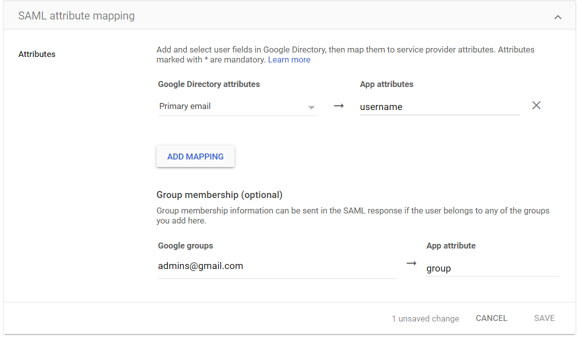

    In Google workspace I have added the group in App attribute.

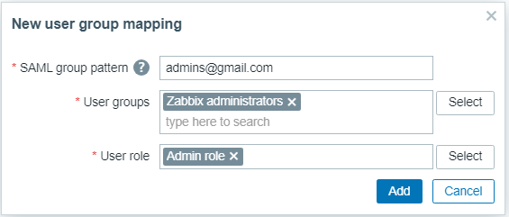

    The issue is now resolved. I'm successfully able to login via SSO as a JIT provisioned user.
    The only mistake I made is to mention the Group Name instead of the Group Mail ID.
