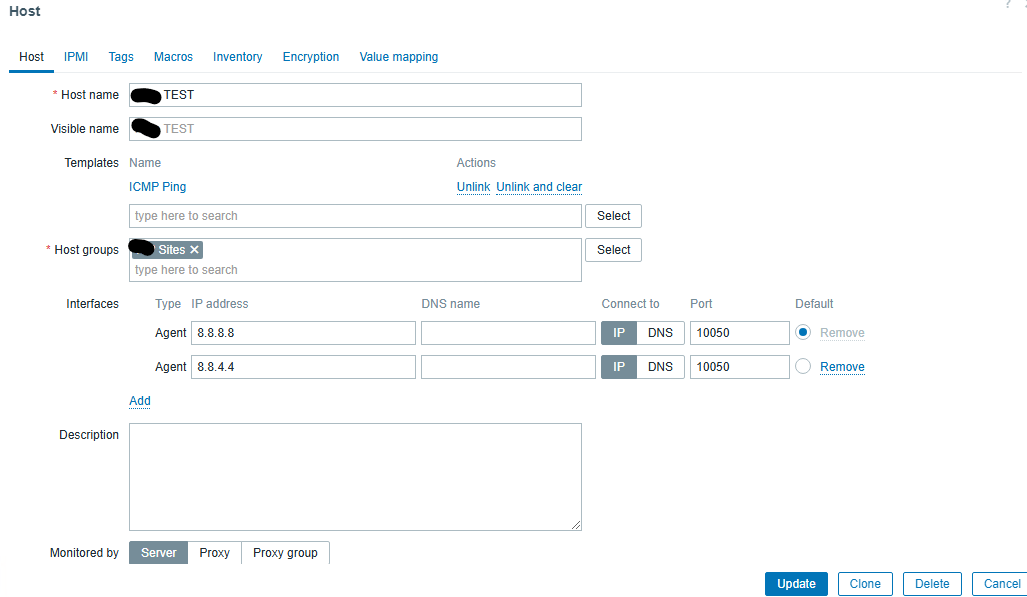

      • Simplex
        • Jan 2025
        Apologies for the next part to this question...
        If I have a host setup like this for example how do I differentiate between the host interfaces for the trigger expression like you suggested?
        I have a lot of these to setup so I was planning to duplicate the "ICMP Ping" template and add the triggers to this.
