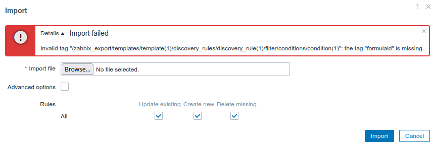

          Copied the suggested all-in-one template (raw view) in a file and imported this file in Zabbix. Sadly I got an error message:

          Enclosed you will find the template. What can I do? Is there an easy solution to this?
            • 5002
            Seems very old version, it will not import ... at least not into 6.0+ Going importing/exporting through some older version might help, but who has those...
            <zabbix_export>
            <version>2.0</version>
            Or recreate everything by hand.. copy-paste items and names from xml ..
