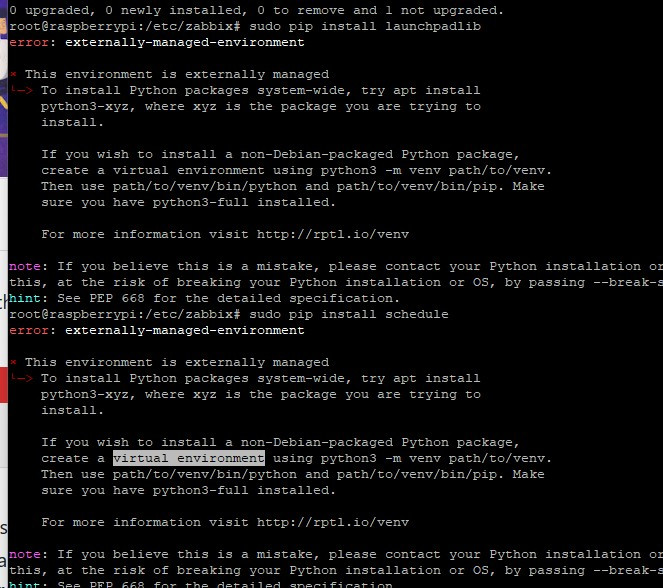

    If you are questioning as to why I am running this in a virtual environment, please see the attached screen shot

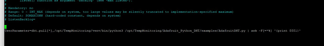

        in the zabbix_agentd.conf, I have added the following:
        AllowKey=system.run[*]
        UserParameter=dht.pull[*],/opt/TempMonitoring/venv/bin/python3 /opt/TempMonitoring/Adafruit_Python_DHT/examples/AdafruitDHT.py | awk -F[=*%] '{print $$$1}'

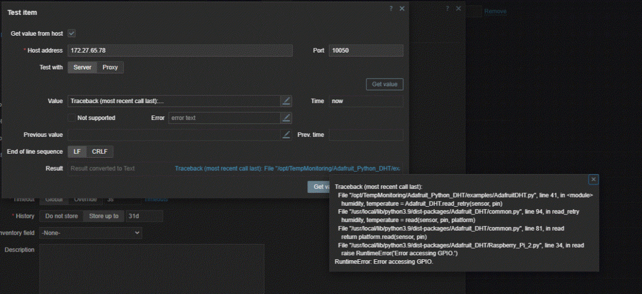

        on the Zabbix Server for the host I created the Item called Temp Sensor using the key system.run[python3 /opt/TempMonitoring/Adafruit_Python_DHT/examples/AdafruitDHT.py 11 4]
        but when I run or test the command, I keep getting the following errors
        Click image for larger version  Name:	Item2.gif Views:	1 Size:	342.7 KB ID:	498295
        with errors out looking for library files in the /usr/local directory

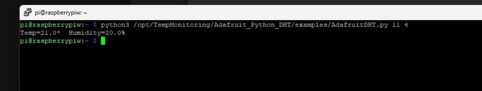

        I can run the command python3 /opt/TempMonitoring/Adafruit_Python_DHT/examples/AdafruitDHT.py 11 4 without issue from CLI

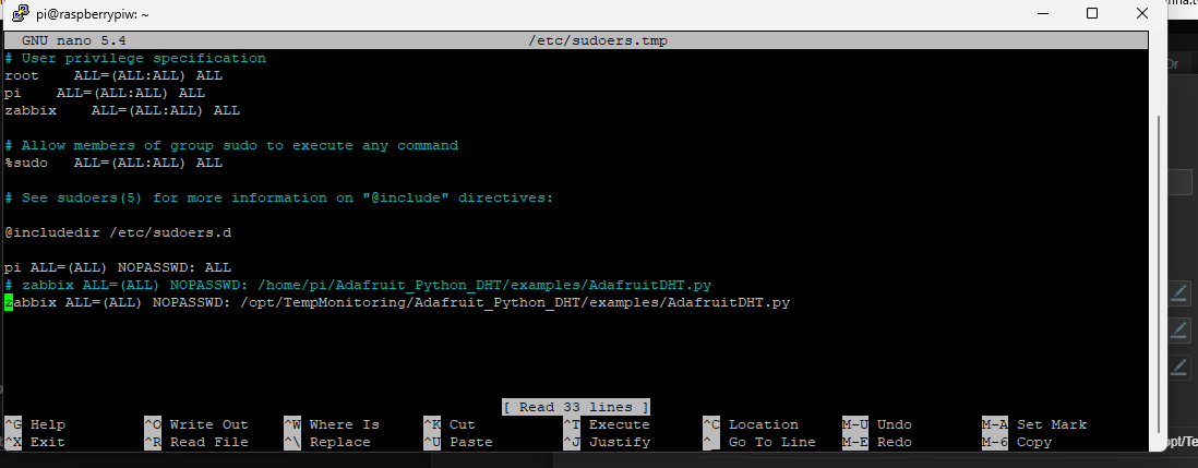

        I even added the following in visudo
        Where am I going wrong?

        • Blevar
          • Jan 2025
          • 68
          Check if Zabbix have access to GPIO:
          sudo usermod -a -G gpio zabbix
          and restart your PI.
          • The-Tech
            • Jan 2022
            • 29
            Ok thanks, I didn't think about that option
