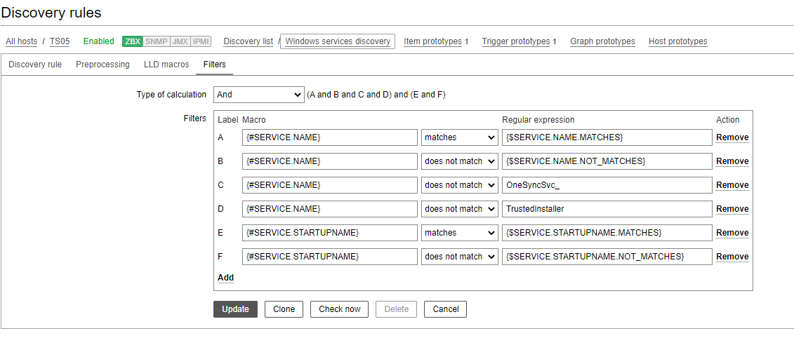

              Basically I went to the windows service discovery in the template I was trying to change and created a filter where #SERVICE.NAME does not match #SERVICE

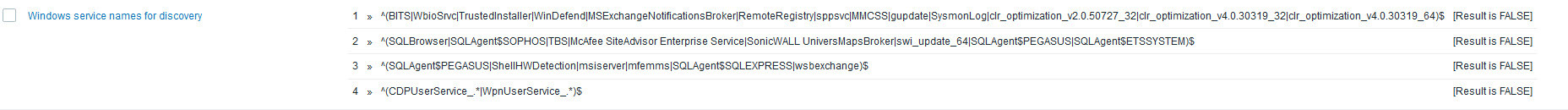

                • scanner16
                  • Apr 2018
                  I found the issue is to do with the amount of items on a line,
                  when I added all the services to be excluded on one line it would not work,
                  if I split the line into smaller groups it worked.
                  the last entry, I added today to exclude these services which constantly change the suffix. result no more notification.
                  Hope this helps

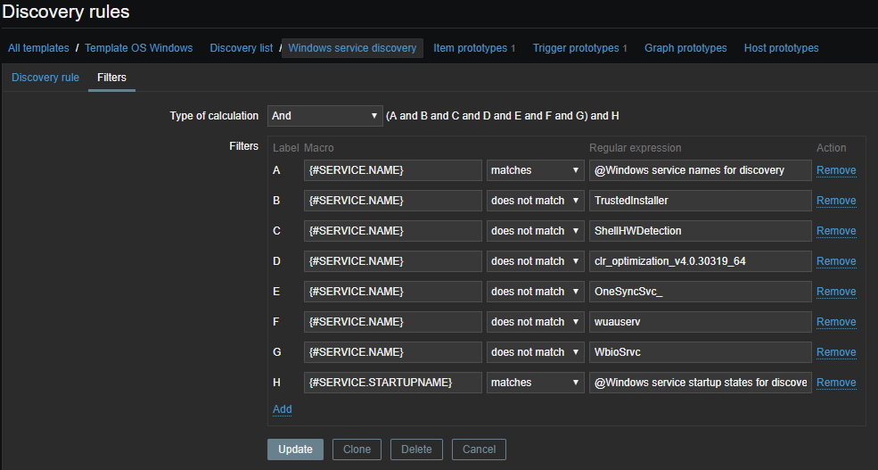

                  • havoc2k10
                    • Jul 2020
                    • 9
                    Does not work for me still triggers the alerts that we added in the regular exp

                      • mindracer
                        • Feb 2021
                        Found in another thread: Open "Template OS Windows" -> Discovery rules -> Windows Service Discovery -> tab "Filters" -> check @Windows service names for discovery
                        Open Administration -> General -> choose "Regular Expressions" in top right corner -> find "Windows service names for discovery" and add "BITS"
