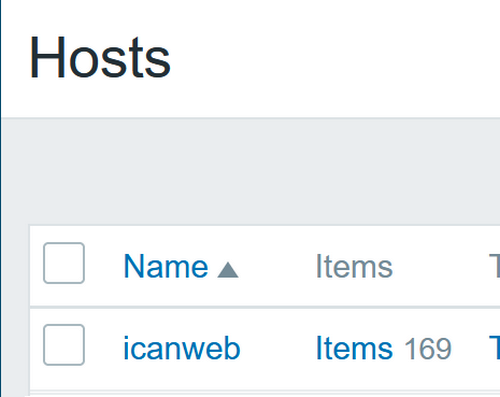

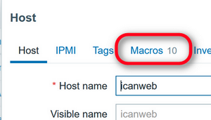

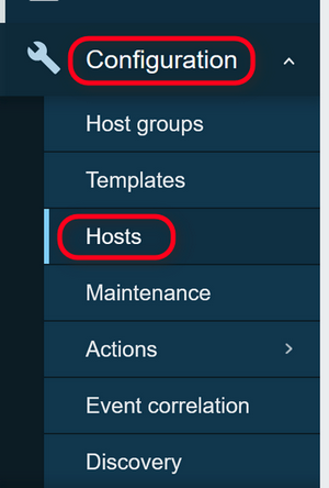

        • dunnsland
          • Dec 2021
          • 81
          PavelZ
          Thanks again for responding ... The last post I provided was the solution that fixed the issue.
          This is below.
          I changed the Hostname in the zabbix_agentd.conf file set that to
          Hostname=127.0.0.1
          Under Configuration, Host, I edited the MACROS under the server name in the Zabbix Config Dashboard.
