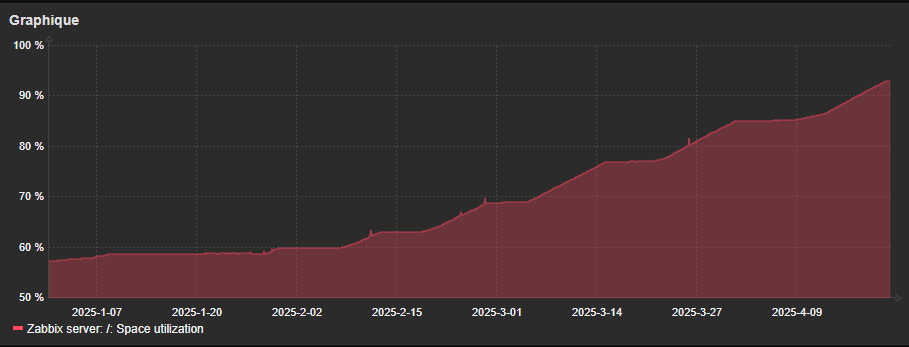

    I'm coming to you because I've noticed that housekeeping doesn't delete enough data or doesn't have enough time to delete everything. Indeed, I have already increased the disk size of my VM at the end of 2024 and is already excessively increased. Attached is a snapshot of disk space since January 1, 2025 :

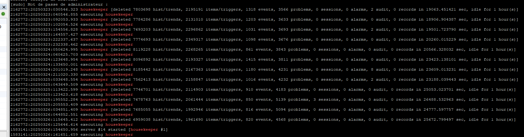

    I've also seen that the housekeeper works well: “cat /var/log/zabbix/zabbix_server.log | grep housekeeper” result of the attached command :
    Can you interpret the result? Do you know the best practices for regulating this parameter to normal? Here's some additional information:

    Don't understand why you don't show data that allows you to estimate the scale of the installation?
    For example, the size of the database in bytes and number of values, NVPS
    It is obvious that with a duration of 25000s and a launch frequency of once per hour (HousekeepingFrequency=1), this process does not have time.
    Deleting historical data is not a strong point in Zabbix. Therefore, solutions like mysql partitioning and postgresql timescale are popular. These solutions delete data in large blocks and quickly
