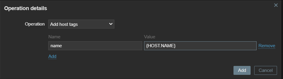

    I need your help. I'm unable to assign a dynamic tag via autoregistration.
    I'm using Zabbix 7.0.11 with Agent2 (active agent).
    I would like the host to be assigned a tag with value = hostname when it is created.
    • 4993
    This does not work?

      The solution isn't working. Here is the result/output.Click image for larger version

        It works... but it works during event generation. Here in config it will stay as a macro, only to be replaced with real value, if any trigger from that host fires and inherits all tags and values.

          Okay, but then how can we have a dynamic tag with the hostname value ?
            • 4993
            I dont get the question... It is as dynamic as it can be... every event from that host will have a tag service with value set to current hostname... From you pic service:VMTESTZBX...
