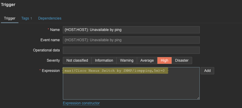

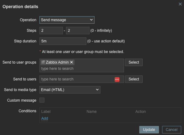

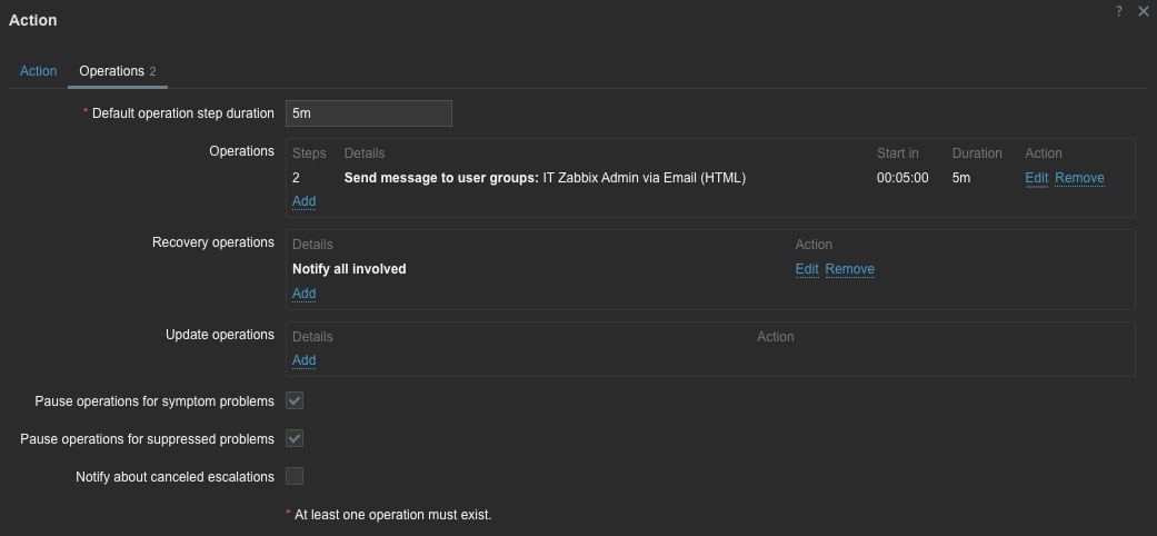

      Thank you. I appreciate the information. Does the following look corrrect? Also, do I need to change the expression on a trigger that has a 5m delay (which didn't seem to work) as seen in the screenshot attached?

      • swildy
        • May 2025
        For the trigger, take a look at the item key. It should look something like this:
        max(/host/icmpping[{HOST.HOST}],5m)=0
          Click image for larger version  Name:	SCR-20250529-hxkl.png Views:	14 Size:	39.1 KB ID:	503617 Click image for larger version  Name:	SCR-20250529-hxhw.png Views:	14 Size:	50.8 KB ID:	503619 Click image for larger version  Name:	SCR-20250529-idei.png Views:	14 Size:	33.0 KB ID:	503618
          This should work. If trigger does, what you want it to do, then no need to change. As I read it, max value for 5m period is 0, meaning it has been down for 5 mintues, then triggers... After that you will have additional 5m grace period before email is sent due to your action config... if things get ok during that time, email is not sent..
          {HOST.HOST} is not a mandatory parameter there. None of icmpping paraemters are mandatory, if not present it will default to host itself anyway, so no need to redefine it...
