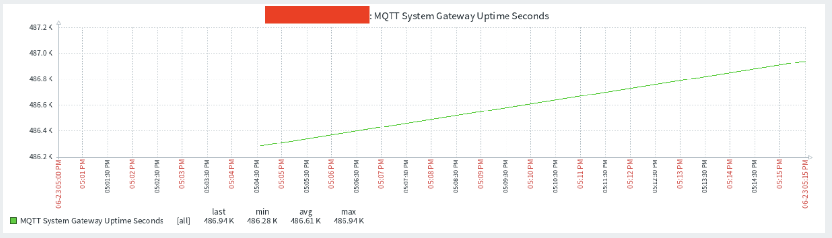

    Okay, so now it turns out that once I got the exact string I was looking for, I was able to easily turn that into a number. Here's my pre-processing steps now:
Name:	Screenshot 2025-06-23 at 5.08.48 PM.png
    I also updated the jSONPath slightly, to account for the possibility that I might get multiple updates in the same MQTT message. We might lose a bit of data here, but as quickly as we're getting the data from MQTT, those should happen within the same second and that shouldn't be an issue:
    $['spBv1.0/Zabbix/DDATA/System/Gateway'].metrics[?(@.name == "UptimeSeconds")].value.first()
    So, I consider this to be my final answer for getting a single data element from Ignition SCADA via MQTT and getting that into Zabbix server in a format that can be graphed. Here is the very bland looking graph that results: Click image for larger version
Name:	Screenshot 2025-06-23 at 5.15.47 PM.png

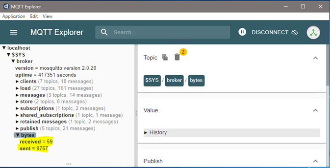

          Hi BradKnowles,
          We also have couple of PLCs which can report diagnostic data over MQTT and I was thinking to use Agent2. The only problem was Sparkplug B format because those PLCs do not support classic JSON so I gave up.
          For basic connectivity test I would suggest to install free mosquitto broker on test machine and verify you can see data in MQTT explorer on the same machine. And then try to read sent/received bytes into Zabbix.
          Good luck!

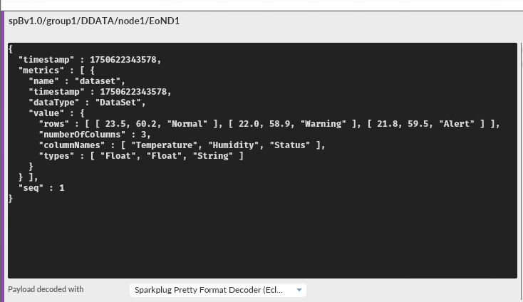

              The JSON we're trying to extract from looks like this:
              {"timestamp":1750455084054,"metrics":[{"name":"Performance/Memory Usage","timestamp":1750455083554,"dataType":"Int32","value":386320320},{"name":"CurrentDateTime","timestamp":1750455083594,"dataType":"DateTime","value":1750455083594},{"name":"UptimeSeconds","timestamp":1750455083594,"dataType":"Int64","value":225093}],"seq":134}
              If you un-wrap that with jq, it looks like this:
              echo '{"timestamp":1750455084054,"metrics":[{"name":"Performance/Memory Usage","timestamp":1750455083554,"dataType":"Int32 ","value":386320320},{"name":"CurrentDateTime","ti mestamp":1750455083594,"dataType":"DateTime","valu e":1750455083594},{"name":"UptimeSeconds","timesta mp":1750455083594,"dataType":"Int64","value":22509 3}],"seq":134}' | jq -S

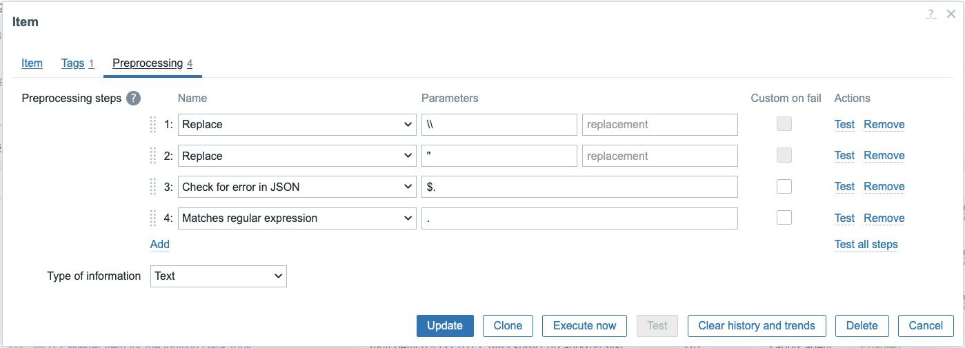

                  So, one thing I've discovered is that the JSON being sent to the Zabbix server is being munged in the process. It's coming through with backslashes and double-quote characters. If you try to verify that the JSON is valid as your step #1, you get an error from JSONPath. If you use regular expressions to strip all backslashes and all double quote characters, now the JSON is valid.
                  Here's an example of an invalid JSON string:
                  {"spBv1.0/Zabbix/DDATA/System/Gateway":"{\"timestamp\":1750705505820,\"metrics\" :[{\"name\":\"Alarming/Clear and Unacked\",\"timestamp\":1750705505320,\"dataType\" :\"Int32\",\"value\":4},{\"name\":\"Alarming/Clear and Acked\",\"timestamp\":1750705505320,\"dataType\":\ "Int32\",\"value\":1},{\"name\":\"Alarming/Clear and Acked\",\"timestamp\":1750705505320,\"dataType\":\ "Int32\",\"value\":0},{\"name\":\"Alarming/Active and Unacked\",\"timestamp\":1750705505320,\"dataType\" :\"Int32\",\"value\":1},{\"name\":\"CurrentDateTim e\",\"timestamp\":1750705505810,\"dataType\":\"Dat eTime\",\"value\":1750705505810},{\"name\":\"Uptim eSeconds\",\"timestamp\":1750705505810,\"dataType\ ":\"Int64\",\"value\":475515}],\"seq\":164}"}
                  And here's an example of a valid JSON string:
                  {spBv1.0/Zabbix/DDATA/System/Gateway:{timestamp:1750708108759,metrics:[{name:CurrentDateTime,timestamp:1750708108258,dataType:DateTime,value:1750708108258},{name:UptimeSeconds,timestamp:1750708108258,dataType:Int64,value:478118}],seq:50}}
                  See the attached screenshot showing what my pre-processing steps are now that validate the JSON and at least capture the whole JSON string and bring it into Zabbix server: Click image for larger version  Name:	Screenshot 2025-06-23 at 2.56.49 PM.png Views:	0 Size:	69.9 KB ID:	504404
                  This works to at least let me see the data in the Zabbix server web GUI, and I can go back and look at the history of previous values.
                  I'm still stumped on the part about properly parsing the JSON to pull out the specific value we want.
                  EDIT: But at least now we know we have valid JSON.
                  Last edited by BradKnowles; 23-06-2025, 22:49. Reason: Add footnote about knowing we now have valid JSON
                  • BradKnowles
                    • May 2025
                    • 24

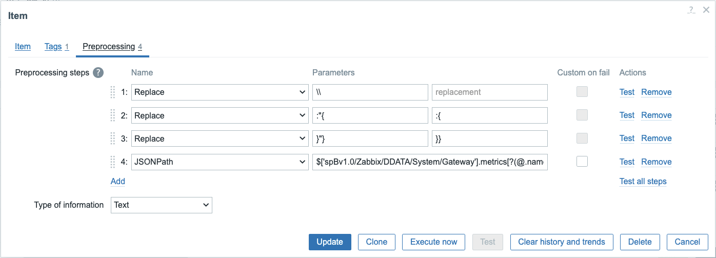

                    Oh, boy. This is even better. You can't trust the internal JSON validator. Because stuff it validates successfully will still cause JSONPath to barf. Also, you can't remove all double quote characters, just the ones that are incorrectly placed around the outermost object braces. Testing with https://jsonformatter.org/json-parser to get the JSON correctly formatted has really helped.
                    So, you do still need to strip out the backslashes. Starting with this invalid JSON string with the backslashes removed:
                    {"spBv1.0/Zabbix/DDATA/System/Gateway":"{"timestamp":1750713947678,"metrics":[{"name":"CurrentDateTime","timestamp":1750713947178,"dataType":"DateTime","value":1750713947178},{"name":"UptimeSeconds","timestamp":1750713947178,"dataType":"Int64","value":483957},{"name":"Performance/Memory Usage","timestamp":1750713947257,"dataType":"Int32","value":722997864}],"seq":27}"}
                    The corrected JSON string is:
                    {"spBv1.0/Zabbix/DDATA/System/Gateway":{"timestamp":1750713947678,"metrics":[{"name":"CurrentDateTime","timestamp":1750713947178,"dataType":"DateTime","value":1750713947178},{"name":"UptimeSeconds","timestamp":1750713947178,"dataType":"Int64","value":483957},{"name":"Performance/Memory Usage","timestamp":1750713947257,"dataType":"Int32","value":722997864}],"seq":27}}
                    This latter string will validate at https://jsonformatter.org/json-parser but the earlier string will not. Unfortunately, JSON parsers aren't very good at telling you what is really wrong with your JSON.
                    Now, you need to strip out the double quote character before the brace enclosing the first "timestamp", and you need to strip out the last double quote character before the final closing brace. Here's what that looks like:Click image for larger version  Name:	Screenshot 2025-06-23 at 4.38.59 PM.png Views:	0 Size:	70.2 KB ID:	504408
                    Now, the JSONPath string actually came from a conversation I had with Claude. I did have to tell Claude where the web page is that defines how Zabbix works with JSONPath. But when I did that, it gave me the following JSONPath to use:
                    However, this is not quite correct. This still gives me a value as an array of one object, with square brackets around it. Unfortunately, the https://jsonpath.com/ validator did not like me adding ".sum()" to the end of that JSONPath, so I didn't think it would work. However, the JSONPath interpreter in Zabbix did take this, and gave me exactly the value I wanted.
                    However, that number is still being interpreted as a text field. Now I have to figure out how to turn that back into a number that can actually be graphed.
                    Last edited by BradKnowles; 23-06-2025, 23:59. Reason: Update with corrected JSON string

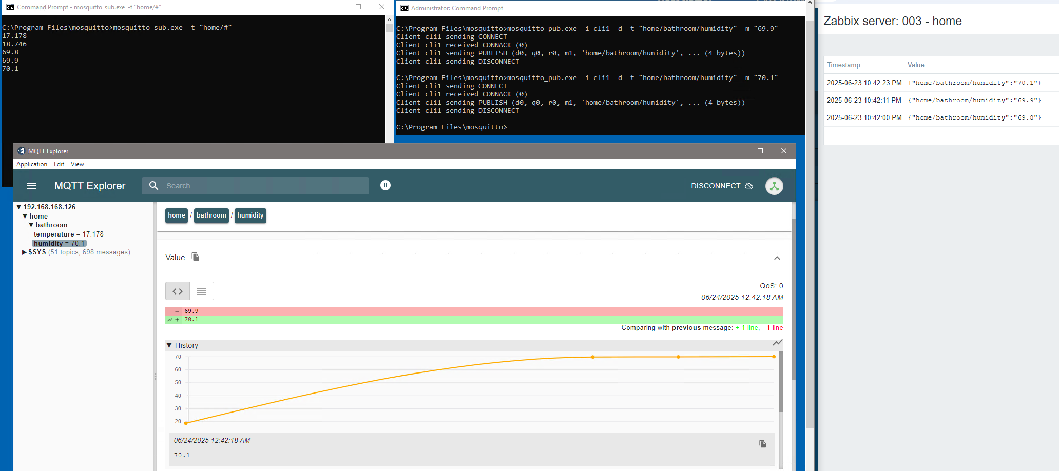

                      • ysus
                        • Mar 2016
                        • 104
                        Hi BradKnowles,
                        Looks like you need to talk to your Ignition admin once again because he did only part of the job. He removed "protobuf" digital encoding but still sending you payload in Sparkplug B format because of spBv1.0/ prefix. This is not a valid JSON which could be easily parsed by Zabbix because it has "dataType", "timestamp" and other fields you do not need.
                        Your topic must be "Zabbix/System/Gateway/#" and not "spBv1.0/Zabbix/DDATA/#"
                        And you shoud receive something like {"UptimeSeconds","478118"}
                        Also I would recommend native "mosquitto_sub.exe" for subscription which is part of Mosquitto broker installation.
                        Don't mess up with preprocessing - Sparkplug payload could have much more complex structure . See examples below.
                          Yeah, I'm fine with ignoring those other values. I'll pull out only the ones I need, and the rest just won't be used.
                          That would be easier to parse, yes. But I've already gone through all this pain to get to where we are now.
                          At this point, it shouldn't be too painful to add more master items for more topics and more dependent items for each datapoint type we want to track.
                          I believe that he only has the proprietary Ignition MQTT data broker on the system. I'm pretty sure that he doesn't have Mosquitto. More importantly, this is on a Linux box and not Windows.
                          Yup, I've seen some of the more complex structure. We're doing other things to help ensure that won't be a problem.

                            In fact, in just a few minutes, I have already added a second datapoint type that we want to track, as another dependent item under the current master item. The graph is already showing up.
                            I'll check to see if there are any other datapoint types we want to track under this master item, and then I will proceed to create a new master item for the next topic we want to subscribe to.
                            • BradKnowles
                              • May 2025
                              • 24
                              And now I have five data elements that I'm pulling out from that one topic, and I've set up a prototype dashboard to collect all that data into one place.
                              I think I'm ready to add the next master item for the next topic.
