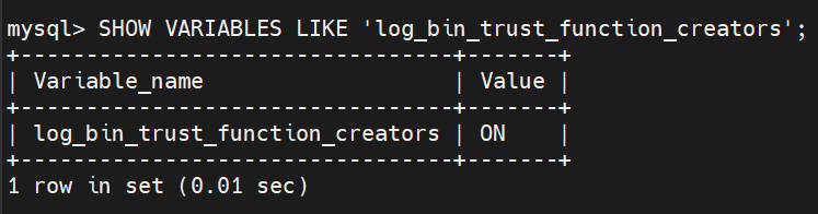

    ​To be clear on the install, I set the bin_trust to on

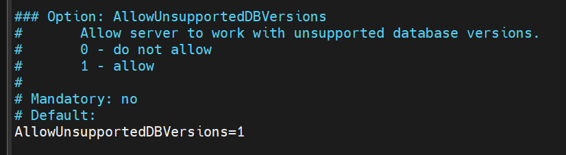

    set the bin trust back to off and the error appears- I even tried the unsupported DB fix

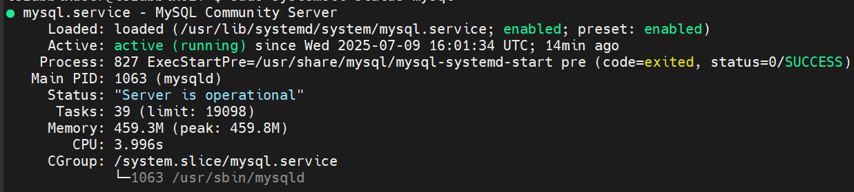

    so this is where I'm stuck

    The Zabbix UI error message tells you that the Zabbix server process has not yet upgraded the Zabbix database.
    Did you restart zabbix-server service after upgrading the server? See also zabbix_server.log for more information.

      I actually figured it out (I did multiple restarts just to stay accurate) Looks like what happened was the dbpassword was actually re commented in the conf, no idea how that happened, but I took the # out and gave it a restart and then the DB updated and now I'm off to the races. Thanks for replying sorry it wasn't a bigger problem.
