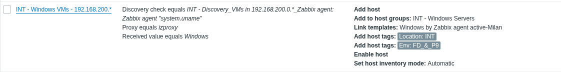

    I got a windows server that is not being discovered even though I have both the discovery actions and discovery rules in place.

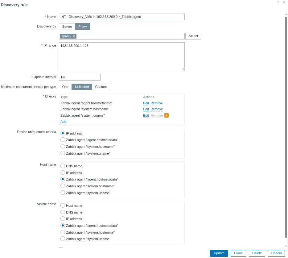

    I attached pictures for the discovery rule and action.
    The same rules and actions are being used for linux servers which have been successful, the windows is the only problem. Windows zabbix logs don't indicate anything that point me in the direction of a resolution.
    Any thoughts?

    Did you test that the Windows agent port 10050 is reachable from the proxy? I see your discovery rule uses proxy but you say that you only configured Zabbix server in the agent's Server directive.
    Markku
    • bloodyskullz
      • Jan 2025
      • 52
      Thanks for posting, yes I tested this and the proxy is able to connect to the windows server via 10050. Connected without issues so I know the windows firewall isn't problematic.

              In your discovery action, you match system.uname with "Windows". Have you checked that your Windows agent returns system.uname with that value?

                    EDIT: I tried changing the discovery action to agent.hostmetadata and that didn't make a difference.

                      How is host metadata configured in the agent?
                      Markku
                      • bloodyskullz
                        • Jan 2025
                        • 52
                        I removed the comment behind the "hostnametadata" and added "=name of server_ip address", every other option for the host metadata is still commented.

                              Please show the current discovery rule and agent configurations.
