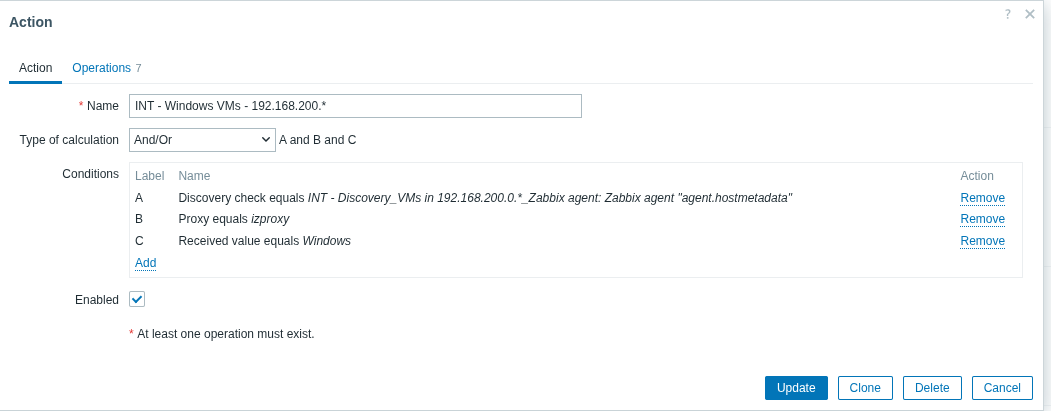

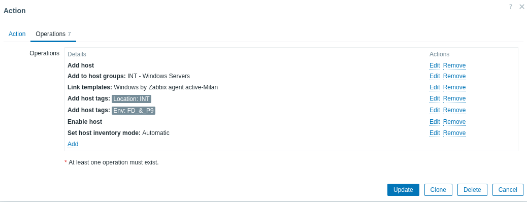

    Sure thing:
    Discovery actions:

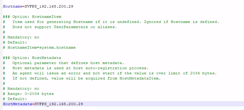

    And then this is a snippet of the config file:
    Does that cover what you need?

      #17
      Your discovery rule:
      Your HostMetadata:
      Shouldn't you be matching "SVFPS_192something" instead of "Windows" in the rule?

        #18
        Your HostMetadata:
        Markku
        Isn't the first condition supposed to be the matching requirement for it to work in discovery?
        My understanding is that if its windows and the hostmetadata name is found it applies to that discovery rule being set. I have other ones with the wording "contains linux" and it works fine. Could the wording of the condition be the reason?

            #20
            To be clear (just tested this): Your discovery rule gets the agent.hostmetadata value from the agent, and then you use it in the discovery action. Since your agent metadata is "SVFPS_something" and your discovery action just checks equality to "Windows", it won't match.
