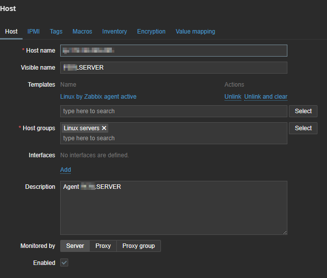

    The host is configured like this :
    But my active check is "Unknow".

ID:	505501The monitoring seems works correctly.
    An other linux server configured with same parameters and the active check works perfectly.
    I don't see reject packet on my firewall, don't have errors on /var/log/zabbix/zabbix_server.log or on the /var/log/zabbix/zabbix_agent2.log (on host)...
    Have you some idea about this problem please ?
