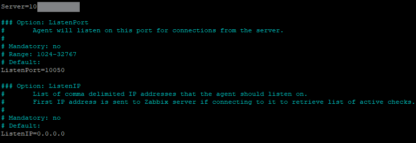

                This works for both windows and linux
                Server=theipfromtheserver
                ListenPort=usually10050
                ListenIP=iusuallyleaveitlikethat

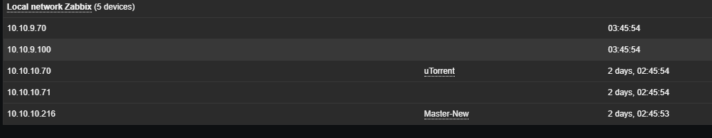

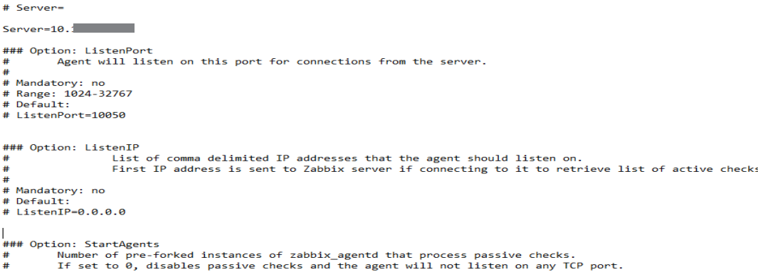

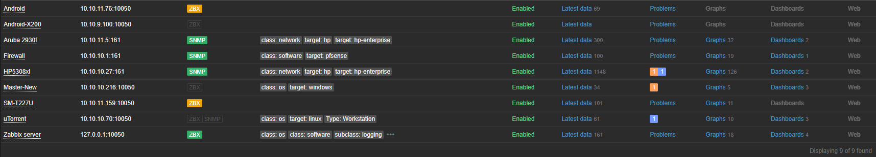

                  I had the ListenIP #'d out. Set it to what you have. Here is an odd thing. I have a zabbix_agent2.conf, but not a zabbix-agent2.conf _ vs - Which is correct?
                  Here is the odd part. With Windows WS is found with the agent discovery:
ID:	506590it is Master-New 10.10.10.216. But on the Hosts screen showing unavailable.

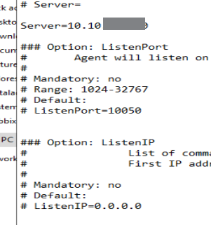

                    2º The agent conf - its even working just whit the server ip so my bad

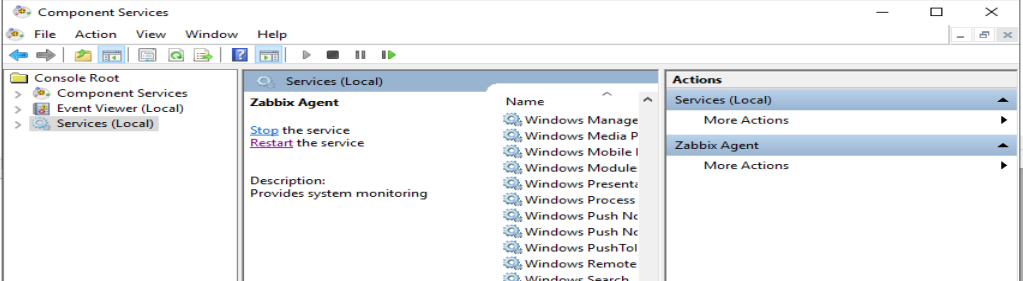

                    3º Agent is running

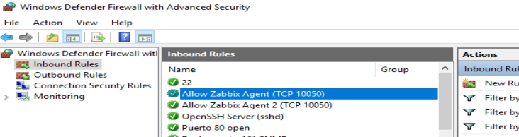

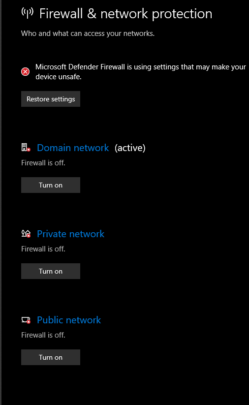

                        I checked the windows firewall settings. As expected the firewall appears to be off.
                        On odd thing, I am getting data from my PI's but the ZBX indicator is off:
                        Is this normal?
                        Greg
                        So Linux sort of working, windows not working...... god I hate windows!
