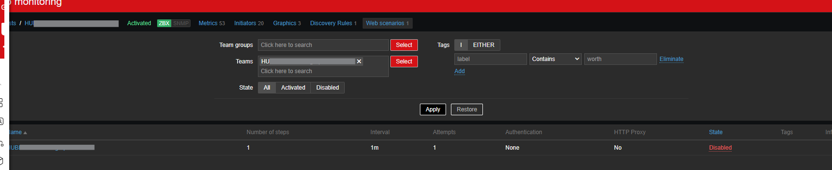

    You can disable the web scenarios Click image for larger version
    or the item itself

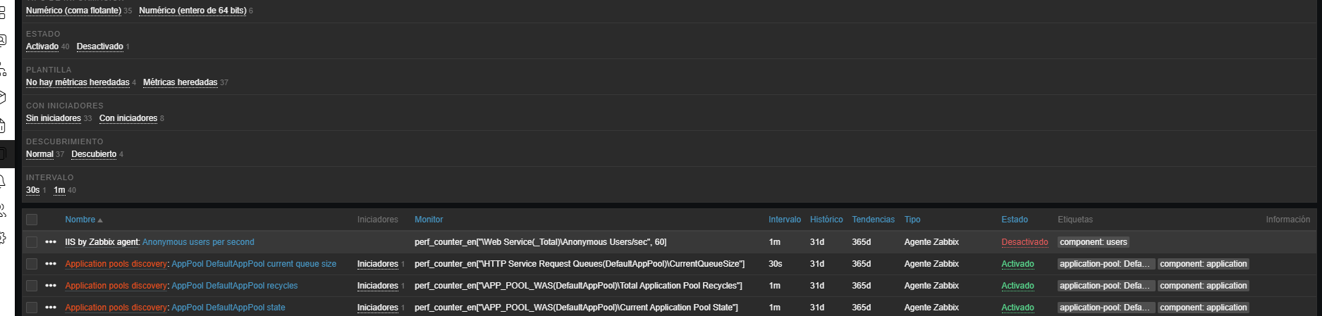

        Im doing it manually , you can click on "activate" do deactivate or pick all of them at once
        First you click on the checkbox above the hosts and then below on "deactivate"

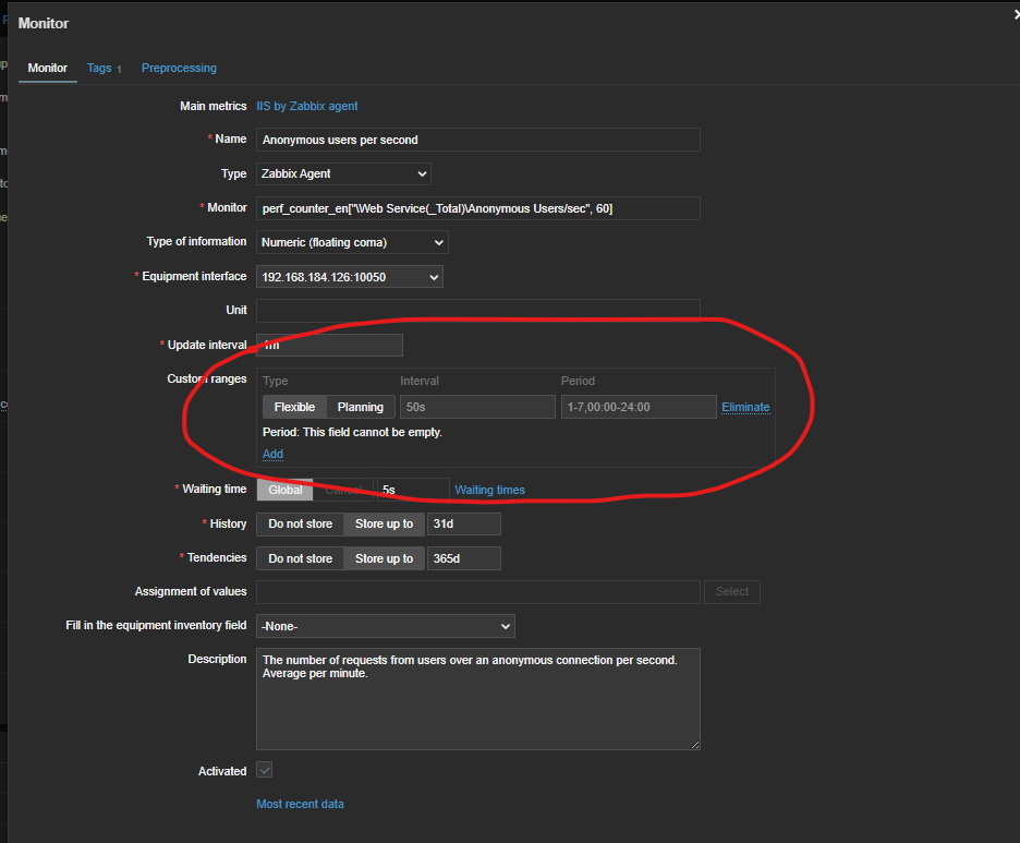

        I think the solution is here , you can modify the items and i believe adjust when they are catching data

          thanks, that's it.
          I forgot about that field in the Item.
          and kept thinking maintenance period meant stop the check not just the data collection.

            actually, web scenarios do not seem to have schedule.
            but thanks for pointing out the schedule on the items for a host
