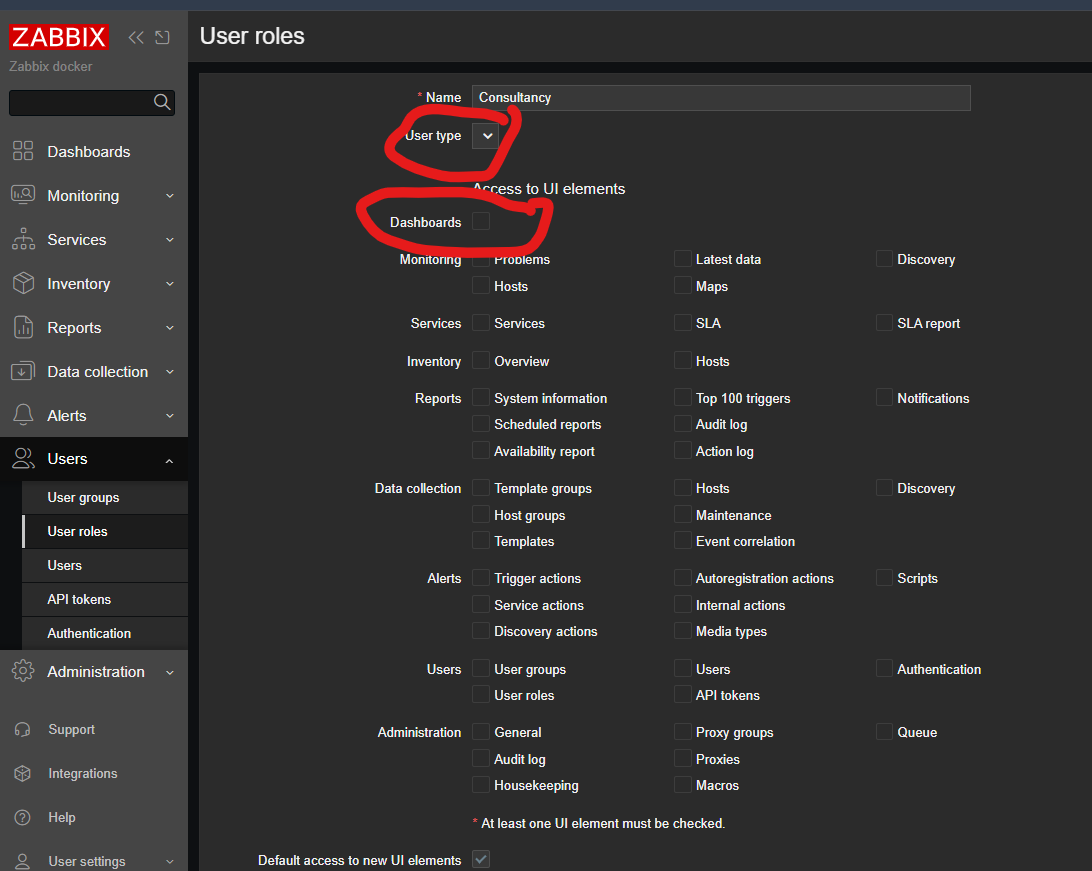

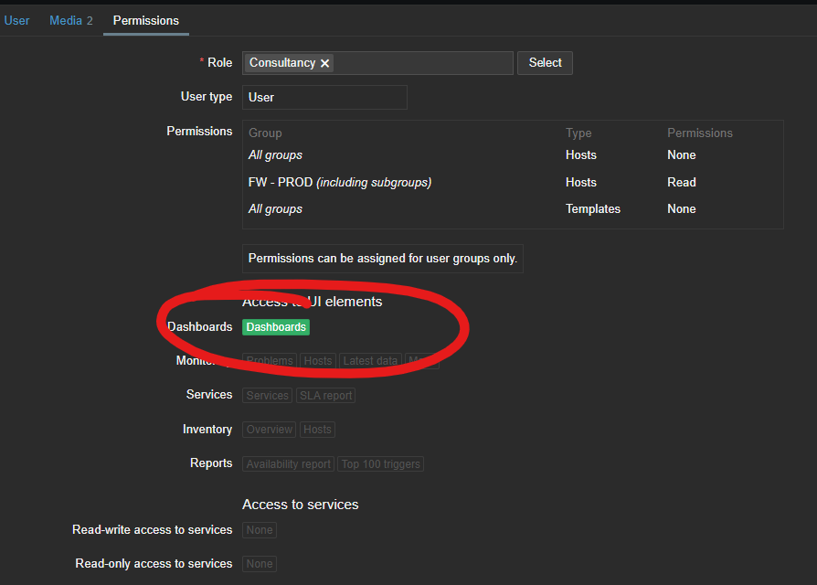

    I notice that since I upgraded to zabbix 7.4.x the User Type selector and selectors of the users are now empty, the values are not filled from the database. The user Type selector is empty, and in this role, the Dashboards check should be activated, as you cansee in the user details:

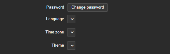

    In the User details, also these selectors are empty:

    Quick update, when I open the console of the browser, I see this JS error
    jsLoader.php?lang=en…uiMessaging=1:22038Uncaught ReferenceError: Cannot access 'Template' before initialization at ZSelect.addOption (jsLoader.php?lang=en…essaging=1:22038:22) at ZSelect.init (jsLoader.php?lang=en…essaging=1:21993:13) at ZSelect.connectedCallback (jsLoader.php?lang=en…Messaging=1:21898:8) atjsLoader.php?lang=en…essaging=1:22579:16
    And it looks like to having the domain behind Cloudflare beign proxied: https://www.zabbix.com/forum/zabbix-...-a-constructor
    Let's see how can it be solved now.

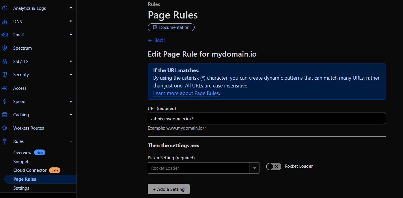

      Ok, I found a way to solve it, and it's to include a Page Rule in Cloudflare to disable Rocket Loader for the hostname needed. I hope it helps somebody else.

        Thank you, mgarcia
        I was looking for the exact configuration that broke my dropdown selectors after enabling everything available in Cloudflare.
        Disabling Rocket Loader did the trick!
        I'm also using the docker image, but deployed via Helm in a k8s cluster, with cloudflared tunnel connected to their WAF. Pretty neat setup, I recommend.
