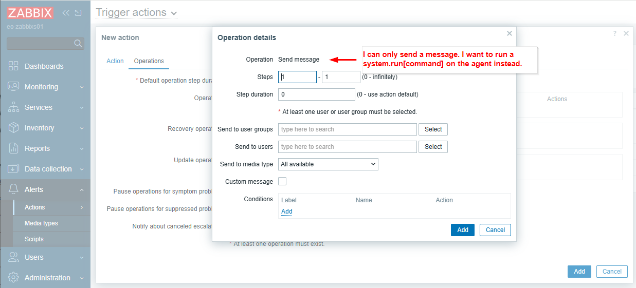

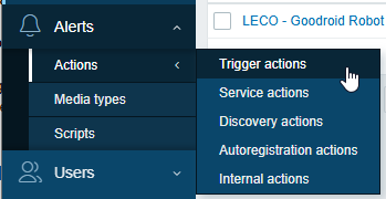

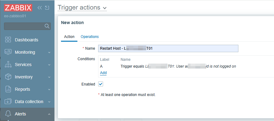

    Let's try to create my conditional remote command action:

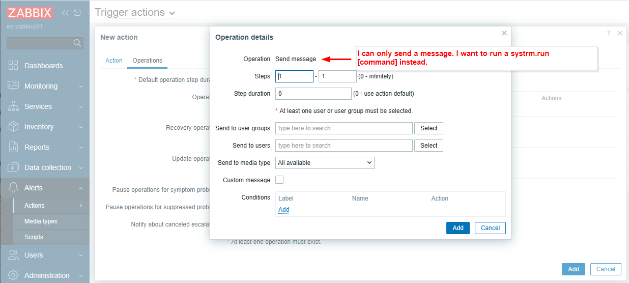

    And here we go, there is no remote command operation​​ available:
    I spent the best part of the day trying to figure it out, but I ran out of options.

    ISiroshtan
    • Nov 2019
    • 324
    Go Alerts - Scripts - Create script - Scope of "Action operation" - Type: Script - Execute on "Zabbix agent" - Fill rest to fit your requirement.
    Then you will be able to choose this script as an operation in action
    Documentation:
    Remote commands
    Specifcally the part:
    Predefined scripts
    Scripts that are available for action operations (webhook, script, SSH, Telnet, IPMI) are defined in global scripts.
    • ezoltan
      ezoltan commented
      Thank you ISiroshtan, that worked. The documentation is isn't that straight forward though. The wording is unclear, and the Operations section of the documentation at https://www.zabbix.com/documentation...g-an-operation makes no mention whatsoever about it.
      Thanks again :-)
