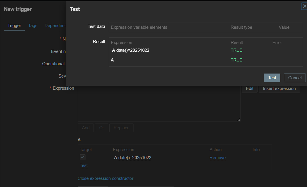

          Seems to accept it. Is there a way to test the trigger without actually forcing the real device to be trigger so I can see if it works?
            • 5002
            There is "expression constructor" link under your trigger expression window... use that.
