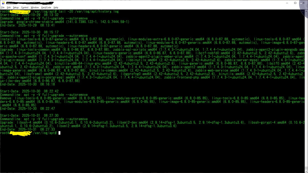

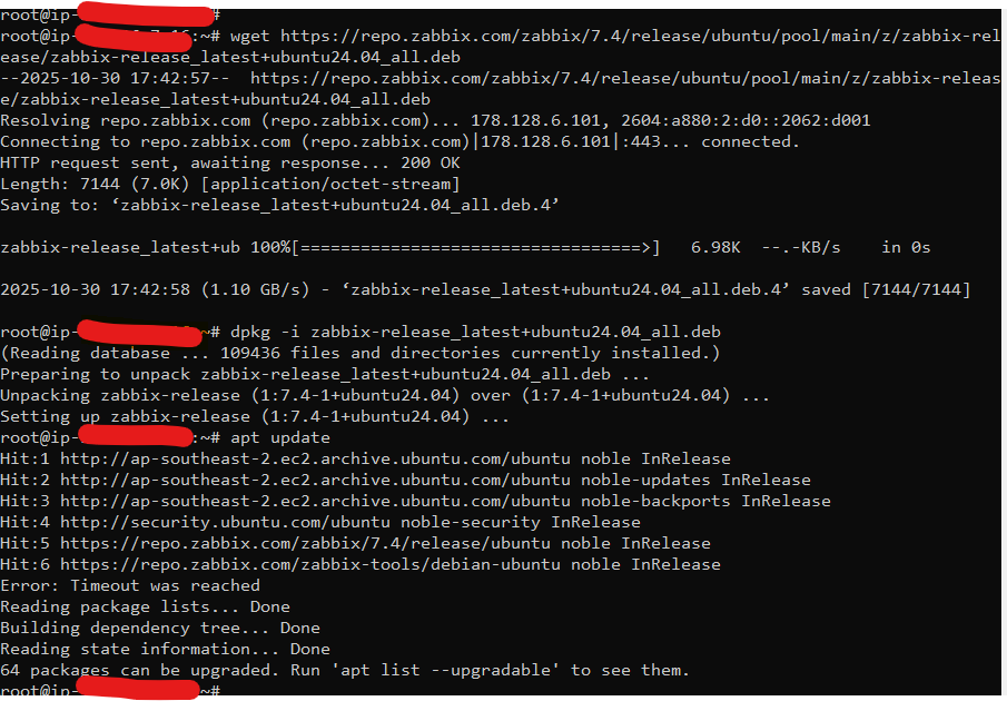

          Hi, thanks for the information but it seems, that I'm still stuck running this - see below screenshot - after I ran dpkg command it doesn't show me something like 7.4.4. Also it appears that after Hit:6 there is a timeout and continues shortly after
          Then I ran apt update but nothing new still. Do I have to update the rest of the 64 packages as well?

            updates for Ubuntu was just released, so perhaps the distribution server is overloaded? > [timeout].
            Zabbix should be upgraded if you run the command
            apt install --only-upgrade zabbix-server-mysql zabbix-frontend-php zabbix-agent(or agent2)
            as mentioned in the aforementioned document. However, since several updates were released yesterday, including linux-headers-6.8.0-87:amd64 and linux-tools-common, it's a good idea to determine which updates you need and install them accordingly.

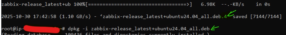

              clean up your downloaded deb files... yu seem to have multiple of them there.. downloaded already 4th but running the first...
