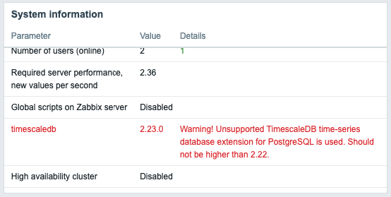

    I’ve spent a while on building a Postgres v18 + TSDB v2.23 virtual server. Then on another server I’ve put the latest version of Zabbix on it plus Nginx and I went through the wizard and connect it to the database and logged in but saw that it couldn’t connect to the database.
    I read somewhere that Postgres v18 + TSDB v2.23 is now supported?
    Anyway I’ve had to add the below to the server.conf and all is working now.
    AllowUnsupportedDBVersions=1
    am I ok to leave it like this? Of should we downgrade to v17 with v2.22?

      Thanks, I just see this, but I guess it's working, but don't know how to tell:
        • 4970
        It is just a warning.. you can still see form DB side if all the compression etc is working .. I woudl say that TS is backwards compatible and if an app is built on some version, which features are still present in a bit newer one, there should not be an issue... with minor version change, I think there are just bugfixes and nothing really gets dropped..

            There is already an open feature request for TimescaleDB 2.23: https://support.zabbix.com/projects/.../ZBXNEXT-10289, implementation progress can be tracked there.
