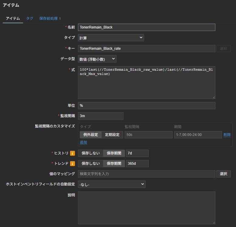

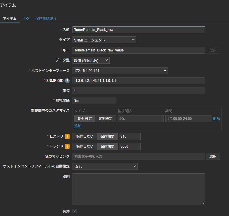

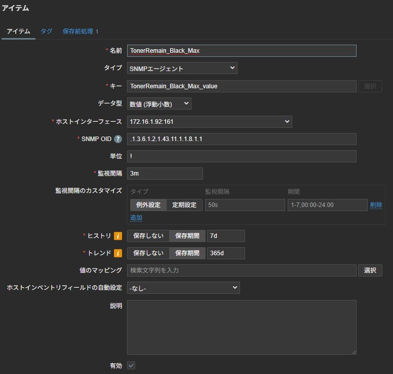

      I'm doing something similar. Try specifying ! as the unit instead of dg.
ID:	509214 Click image for larger version
ID:	509217 Click image for larger version

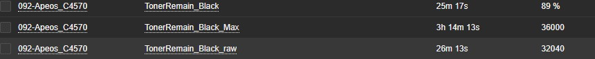

        I noticed that if i go to data collection, it actually works and makes the percentage as in the formula.
        I noticed aswell that the percentage i get from the formula doesn't correspond to the percentage that the printer shows in its webpage.
        Did someone found the OID it refers?

          Check the values received in both items used in the calculated item. This way you can check if you're collecting the correct information from your printer.
          So, verify this items:
          toner_left_black
          toner_max_black

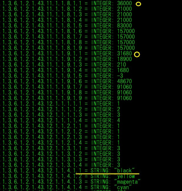

            Based on my limited experience, the order of the OID entries in the toner information was usually Black–other colors. This was true for both FIJIFILM and Canon printers. I no longer have the Ricoh unit, and since I removed its host entry from Zabbix when disposing of it, I can’t confirm how it was structured.
            Regarding the [Left Black Toner] item setting you posted, it references .1.3.6.1.2.1.43.11.1.1.9.1.2, but the correct OID might actually be .1.3.6.1.2.1.43.11.1.1.9.1.1.
            Click image for larger version  Name:	snmpwalk.jpg Views:	0 Size:	254.4 KB ID:	509255
