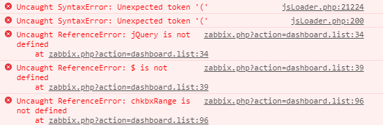

        Here are the errors the browser shows to me
        It's on Chrome Version 80.0.3987.132

          These are Javascipt messages.

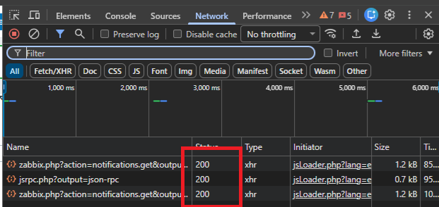

          But DevTools under Network you can see it all your queries was successful. Like this
