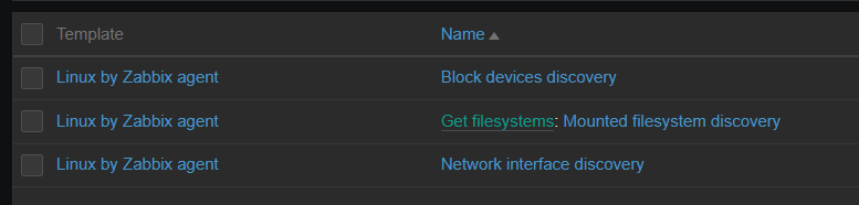

                  Sort of a follow-up question. On my Zabbix frontend, I have discovery in Monitoring and in Data Collection. They both just say Discovery. Which would be referred to as "Low Level Discovery"?
                    • 5002
                    easiest..identifiable by color..
                    For example... in a template "Linux by Zabbix agent" is a list of discoveries
                    Click image for larger version  Name:	image.png Views:	0 Size:	12.2 KB ID:	516714
                    Middle one is of type "Dependant item"
                    it uses this item to query for data and then use that data for discovery
                    Click image for larger version  Name:	image.png Views:	0 Size:	2.0 KB ID:	516715
                    So to refresh discovery, you have to run item "get filesystems" and your disco is executed automatically after that...
                    Menu item Monitoring -> Discovery shows you "network discoveries", the same which are defined in "data collection -> discovery"
