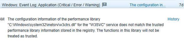

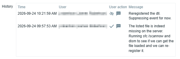

    The challenge I have is I am getting problems for new log events associated with closed/resolved problems. Here is a sample. The original event was for a DLL not have perfmon data. I acknowledged it with some update entries
    and closed. Then today it "came back" with this new event that isn't a repeat of the first one.

    Is there a way to change the trigger to add some kind of unique values to the problem so as I resolve things Zabbix finds, it doesn't bring back old problems as new?

    • 5002
    if you really "closed" the problem. ,it should not come back ever... There is no such feature to reopen any closed event. Suppressing is not closing...

    • jwrober
      • Oct 2026
      Good point on the suppress vs close. However that isn't really the issue. The suppressed problem event was for a different event entirely, so why would it come back up? That's effectively the crux of my question. I'll give the event gen mode: multiple a try as well.
