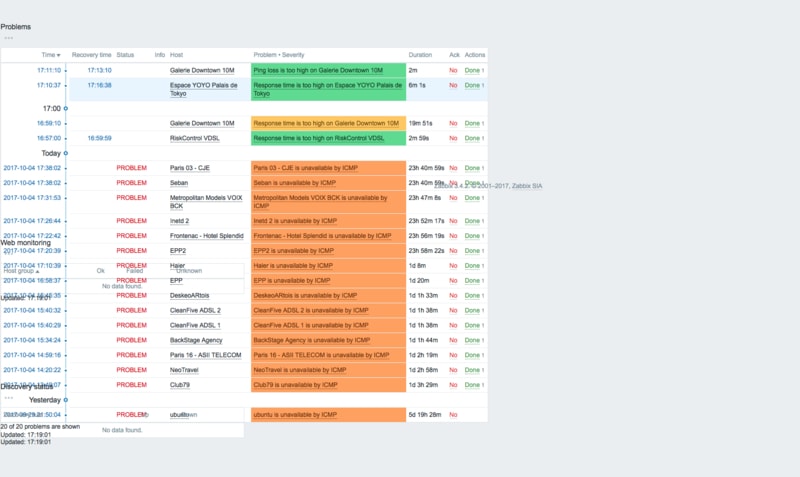

    I just upgraded my Zabbix server on Centos7 and when I go to the frontend, it's not working like it should be. Everything's broken. For example, on the Dashboard, I have something like the picture attached below. I think the problem comes from the PHP but I'm not too sure about this. Can someone explain to me please?

    I believe this was already discussed hundred of times by the community. Try to clean the cache and this should solve the issue.

      Thanks that's solved the problem
