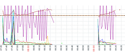

          Result from reducing StartDBSyncers
          I did reduce the StartDBSyncers to 4 the system stayed up for about 40 mins.
          Attached is some graphs of the processes at the time of failing.

                • mellis
                  • Oct 2017
                  • 145
                  Graph
                  This is the internal Processes.
                  violet is the configuration syncer
                  red is the preprocesser manager
                  I believe, sorry for the bad pics,
                  • kaspars.mednis
                    Zabbix Certified Trainer
                    • Oct 2017
                    • 349
                    Anyway, all those processes must be less than 75% busy, better keep them 30%-50% busy max
                    Try to increase corresponding process count in zabbix_server.conf, and restart the zabbix-server process
                    Will look at your sql log little later
                    Kaspars
