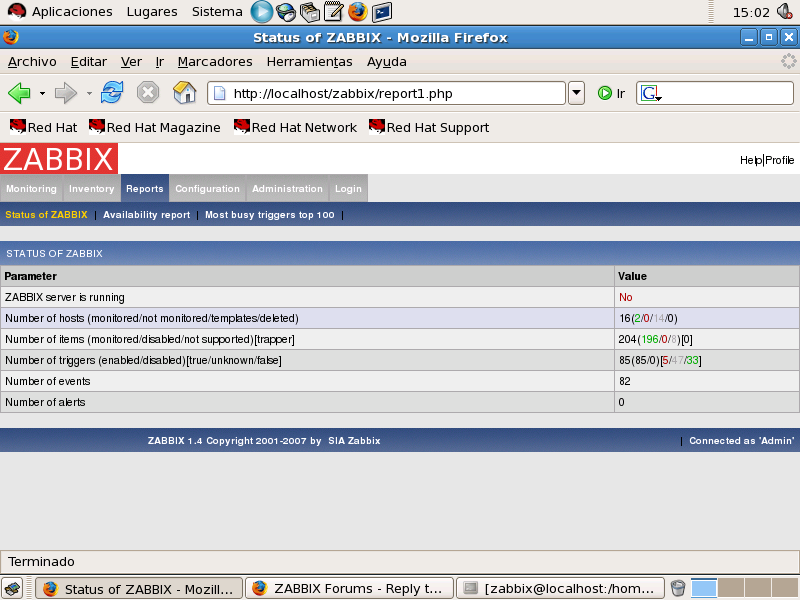

    RHEL 5 not working
    Hello again!! I followed CentOS instructions for RHEL 5, and everything seems to be OK, MySQL, the conf file, etc... the server log shows the same as the log of CentOS , but the RHEL server is not working, I can see it in the report Screen.

        More data
        Well, I can monitorize the server as a host, it seems to work, it's sending data to server, everything seems to be allright, but the Reports window(on the application) shows that the server is not running.
        I add one screenshot and the server log.
        Thank you!!!
        145:20071002:145643 One child process died. Exiting ...
        3145:20071002:145645 ZABBIX Server stopped
        5047:20071002:145647 Starting zabbix_server. ZABBIX 1.4.
        5047:20071002:145647 **** Enabled features ****
        5047:20071002:145647 SNMP monitoring: YES
        5047:20071002:145647 WEB monitoring: YES
        5047:20071002:145647 Jabber notifications: NO
        5047:20071002:145647 **************************
        5051:20071002:145647 server #1 started [Poller. SNMP:ON]
        5052:20071002:145647 server #2 started [Poller. SNMP:ON]
        5058:20071002:145647 server #6 started [Trapper]
        5060:20071002:145647 server #7 started [Trapper]
        5062:20071002:145647 server #8 started [Trapper]
        5064:20071002:145647 server #9 started [Trapper]
        5066:20071002:145647 server #10 started [Trapper]
        5053:20071002:145647 server #3 started [Poller. SNMP:ON]
        5055:20071002:145647 server #5 started [Poller. SNMP:ON]
        5068:20071002:145647 server #11 started [ICMP pinger]
        5071:20071002:145647 server #12 started [Alerter]
        5074:20071002:145647 server #13 started [Housekeeper]
        5074:20071002:145647 Executing housekeeper
        5054:20071002:145647 server #4 started [Poller. SNMP:ON]
        5078:20071002:145647 server #14 started [Timer]
        5081:20071002:145647 server #16 started [Node watcher. Node ID:0]
        5082:20071002:145647 server #17 started [HTTP Poller]
        5079:20071002:145647 server #15 started [Poller for unreachable hosts. SNMP:ON]
        5084:20071002:145647 server #18 started [HTTP Poller]
        5087:20071002:145647 server #19 started [HTTP Poller]
        5089:20071002:145647 server #20 started [HTTP Poller]
        5091:20071002:145647 server #21 started [HTTP Poller]
        5047:20071002:145647 server #0 started [Watchdog]
        5093:20071002:145647 server #22 started [Discoverer. SNMP:ON]
        5074:20071002:145647 Deleted 0 records from history and trends
