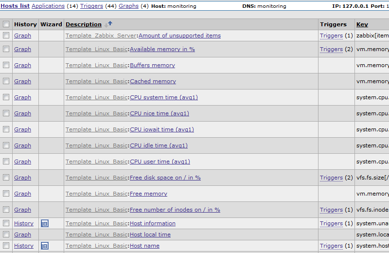

I've written a patch that adds a History column to the page where you configure the Host Items. This column contains either a link to the item's history or to its graphs. See the ConfigureItems.png attachment for this.

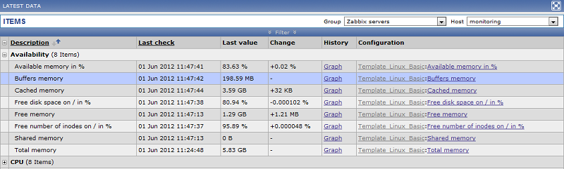

I've then also added a Configuration column to the Latest Data page. This column will contain links to quickly take you to the Template and/or Item's configuration page. See the LatestData.png attachment for this.
